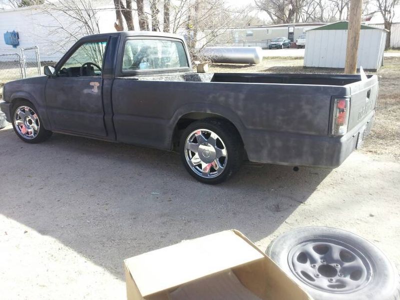

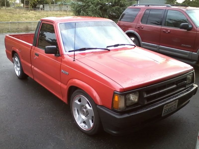

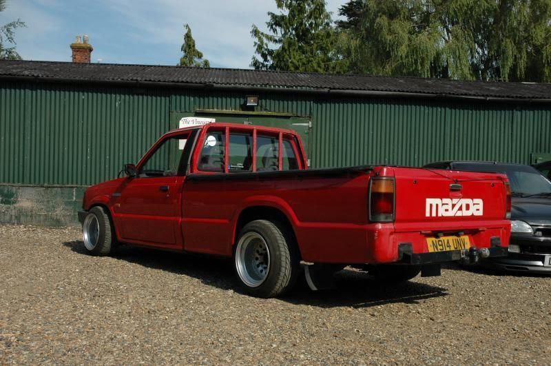

Basically today i finally got around to lowering my truck and it was slightly disappointing. I put on the 3 inch angled blocks and lowered it down and the rears seem to have made no noticeable drop what so ever.
The angled blocks are the correct way round and all the leafs are still in the pack. The bump stops have been removed too.
Now im pretty sure next week im going to Mono leaf the pack to see if it makes much difference BUT im highly skeptical that it will make it drop by another say 3 inches.
Here are some pictures of the outcome of today.
Any help would be greatly appreciated guys as like i said im gonna play with it again next weekend.

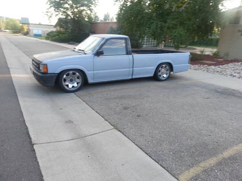

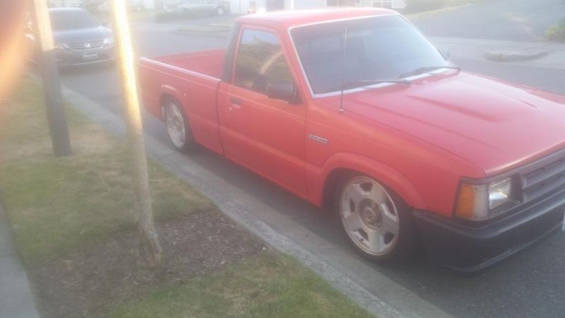

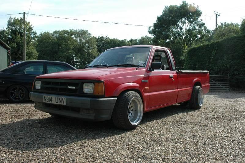

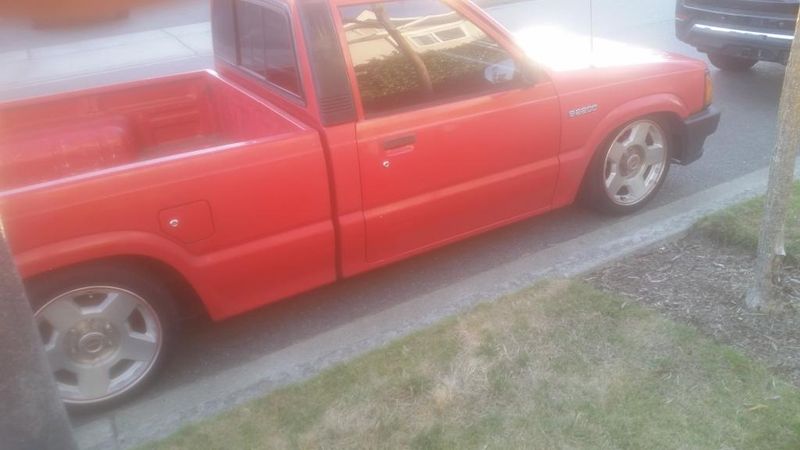

Yep what mml said. Mine was still high with 4 inch blocks in, mono leaf plus overload and now my able sits about 1/2 inch from frame.... Lol bumpy ass ride but looks good.

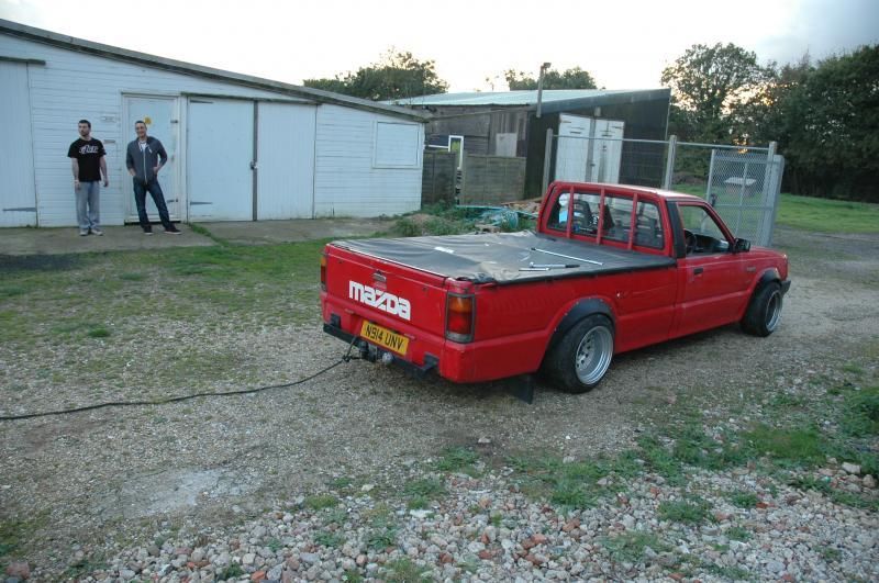

This was before mono leaf
And this is after

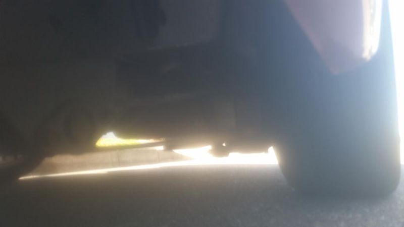

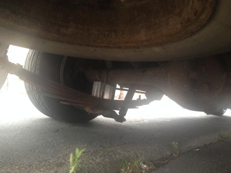

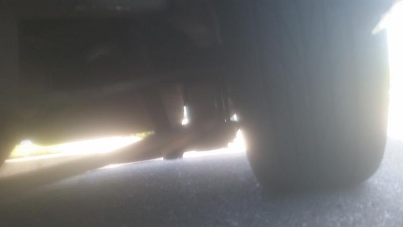

This is a picture of the rear with lowering blocks on, i apologize for the quality.
If i was to mono leaf the rear wouldn't i lose the ability to actually use the truck as a truck? Heaviest thing iv had in the back was a tyre machine so i doubt i could take that again with the mono leaf setup.
