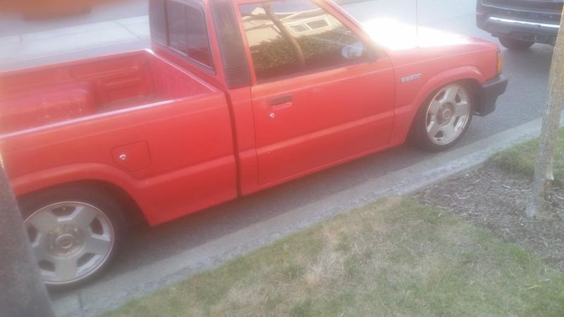

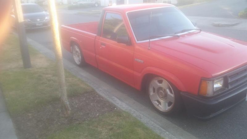

So here is what i did last night. I took one leaf out the back so now i have the main leaf and the thick one what ever that is called. and it gave me about and inch or so drop not as low as i'd like but what are ya gonna do... on the front i just cranked down on the torsion bar bolt till i got what i kinda wanted. I get a little bounch when i hit a bum which is fine... other than that it's ok... i am kinda wish i had smaller rims and tires so i would be lower... but it is what it is till i bag it out in the next year or so... anyway here was the end result after about and hour and a half of work.

What kind if wheels are those?i like those lol trade you some 14" chrome factories lol also have you thought about retorsioning the front? Where you from man?

not sure if i want to trade those are stock mazdas. i am from louisiana but i live in Wa.
