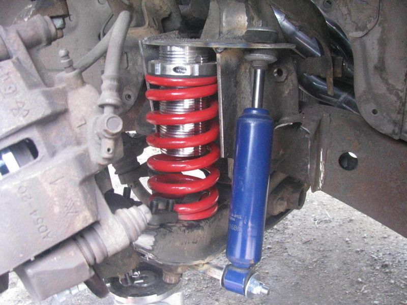

My current front setup with Ebay Civic springs and sleeves. All 3/16 steel bracketry. Anything is better than torsion bars and leaf springs.

More about this setup please? I'm curious about this now, and I happen to have a set of Civic springs. Also more about the rear?

I have 16 inch wheels with 40 series tires in the front. I pulled the torsions out and jacked the wheel up until there was no fender gap. Set the spring in like the pic and welded up some 3/16 for a coil perch and shock mount. Once I put it on the ground I had to turn it up like 5 turns to get it where I wanted it height wise. Very simple compared to bags. All I had to remove was the factory bump stop and lower shock mounts. I haven't gotten to the rear yet. My plan is a wishbone 3 link with a small notch. It handles so much better now. Just with the front done. Torsion bars suck!!! lol

i think i see how you have that set up, i might just order the coilover sleeves and figure it out on my own. thats basically exactly what i was looking for in the front
