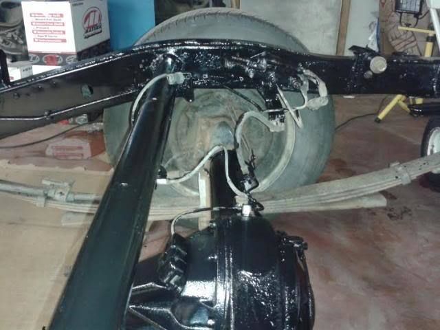

Here are some pics I just took of my lowering blocks, suspension is unloaded, there is no box, or cab, or engine on the frame, just a frame with wheels.
You can see the blocks are pointing slightly forward here, this is the passenger side wheel:
I put a level on the u bolt, and you can see they are no where near straight up and down, this is the drivers side wheel:

I installed some 2 degree shims between the blocks and springs, and it didn't seem to make any difference. I'm going to see how much it will be to shorten my drive shaft a little I guess. I am going to get different blocks also, don't really like these, and after researching about issues I have, I found my blocks are not very good (hollow aluminum), so I will get some steel ones, or at least solid ones.
