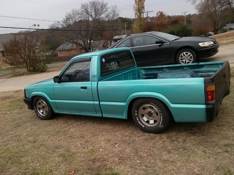

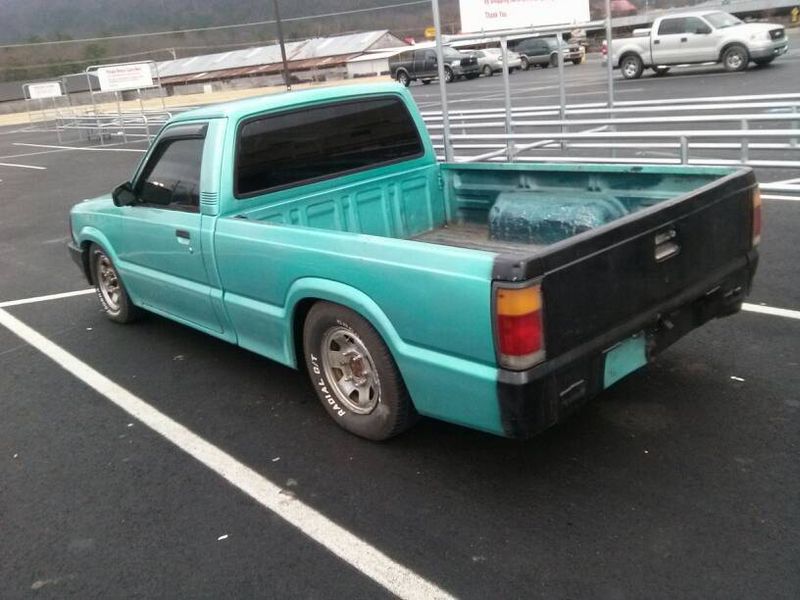

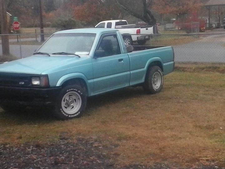

kylesj6033
here is an update of truck as of today
