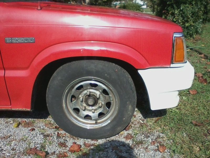

Like i said in previous posts i purchased my truck and it was already dropped, and i'd like to know how much lower i can go, i'll take better pics this evening once i get my 4 way back.

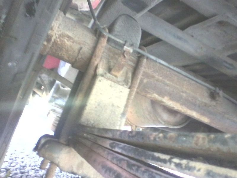

the blocks it's sitting on, can this be adjusted further, and how?

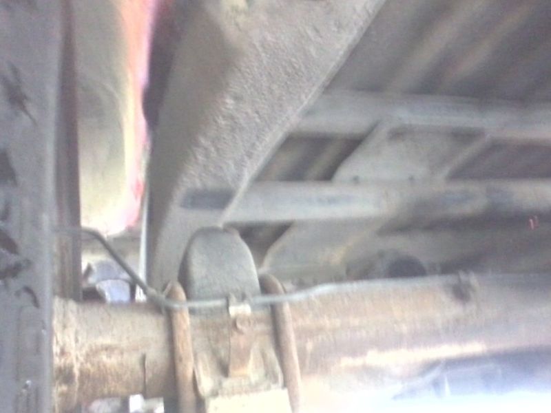

sides of the blocks

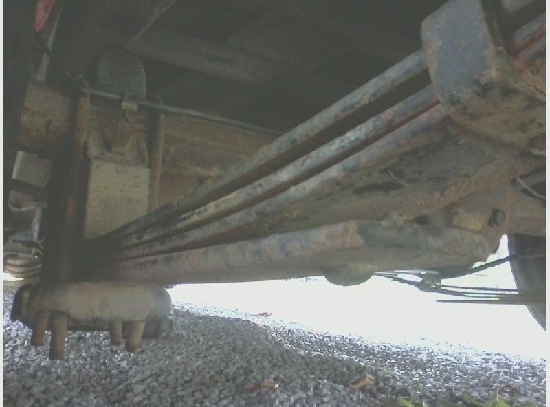

Bump stops and close of how the frame is

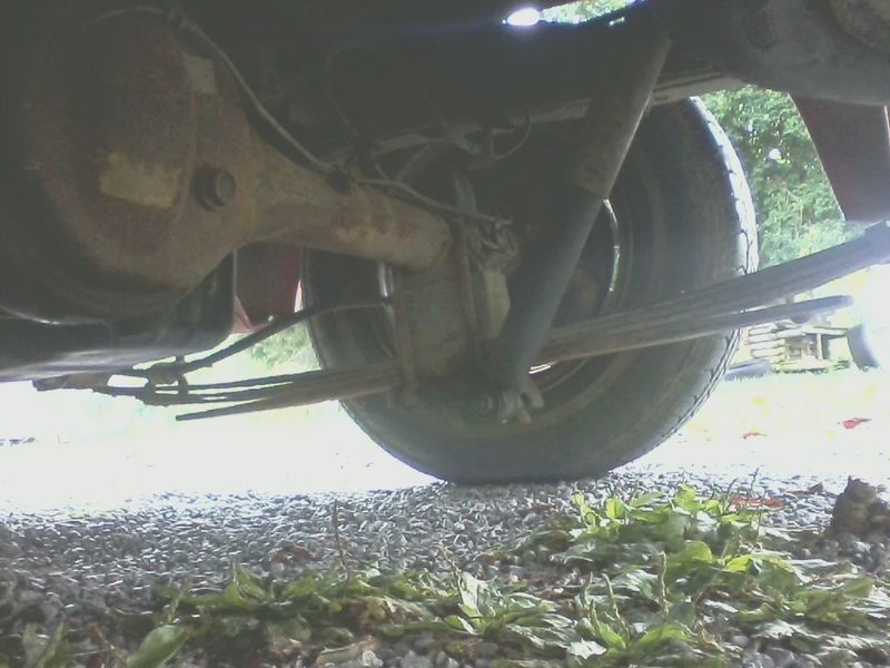

and the leaf springs, can i remove one? Switch the bigger overload onto the top and get lower?

You can swap the block for a larger one or you can remove the two middle leaves. I don't put the overload leaf on top. Some do, but it defeats the point of having it since it's designed to sit under the leaf and keep the leaves from flexing to far in the opposite direction, which is the reason no one runs a monoleaf set up anymore. It MAY last, but it MAY break too.

Id remove the 2 center leafs and put the pack back together. Take the bumpstop out and cut it really low. The drop blocks are held in place by the ubolts and they have a hole in the bottom that sit on top of the leaf spring packing nut and the tops have a pin that sit in a hole inside of the axle itself. Make sure you have the truck lifted and supported by the frame and NOT the suspension or axle, the suspension HAS to be free hanging with no load on it otherwise you can and will hurt yourself.... Watch some drop block install videos on you tube.
