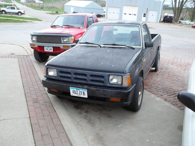

myers503
here is a pic

myers503
perfect thank you. I will measure using these numbers and see what direction I should go
