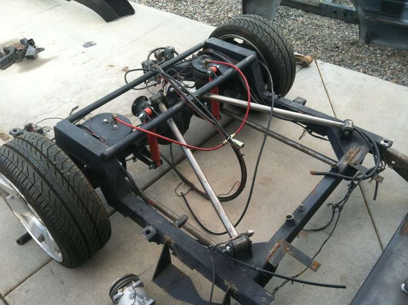

I have a solution for u sitting in my driveway as we speak.

Ill sell it to you cheaper than it would take to buy a set of 4 bags

When I have the money bro I'll be buying that from you. But will it fit my truck?

I'm sure it will, but you might have to add some tails to the frame for the long bed mounts.

Good idea! I never thought of that! For real!
