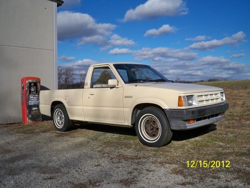

This is what I did. I flipped the main leaf, added used 2 more leafs for a total of 3 leafs, plus the overload spring. Also running a 1" block. I have 1" of travel before it hits the frame rail.
Before
Also I should add I used late 60"s VW Bug rear shocks on the rear, and Isuzu pickup shocks on the front. And this is as low as I could go without cutting something on the truck. The front is 3 splines on the torsion bars, and no bump stops on the front or rear.

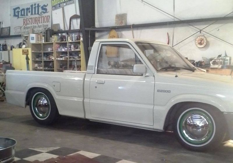

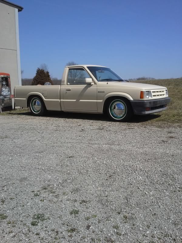

I just finished lowering my 87 B2000. What I did was removed the leaf springs from the truck, disassembled them as described above, flipped the main leaf over, and installed 2 additional leafs for a total of 3 leafs, plus the overload spring. I then used a 1" block. This is how the trucks sits now.
I'm running 235/75/14 tires on the rear. I have about 1" of travel before the rearend hits the frame. It rides good. I've been doing it this way for years without any trouble. I'm running 195/75/14 tires on the front. I think the front needs to come down a little bit more, so I'll be playing with the torsion bar adjustment. Maybe lower it another 1/2 inch.

To answer your question about the front torsion bars, I indexed them 3 notches. The difference in ride height from the before picture and the after picture is 5". In the before picture the truck had 2" blocks in the rear, so if it was at stock height without the 2" blocks, I brought the rear down 7" from stock doing it my way. How ever you do it, make sure it's safe, and I hope you get the results you're looking for. Dean
