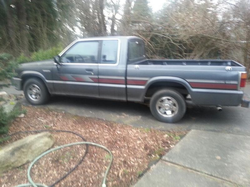

Do u have a pic of it?
Sent from GS2 on Tapatalk
F
firstmazda
My truck? or the truck bed im getting?
