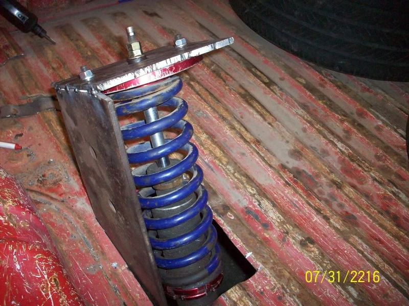

I know this subject is probably ran into the ground, but does replacing front shocks with coilovers really have to be that complicated? There's a guy on here who built a drift truck with a 350, and in the rear he just built a bracket for something to mount the tops to. The bottommounted in the stock location from what I understand. Can the same concept not be carried over to the front? May be a dumb question but I don't see why it has to be as complicated as all my research on the matter indicates that it is.

okay so here is jc50942's coilover setup in the rear, which is what sparked the idea. His whole build thread is along the lines of what I want to do anyways, and his disc brake conversion is a great idea and simple enough. I believe he says he just welded the bracket to the frame, and the bottom hooked up in the stock location. I was just wondering if this same methood could work on the front. It'd be nice to ditch the torsion bars. I'm going for a sports truck type deal, something that handles really well. Hopefully this clarify a bit. If this would work, I could just buy the coilover and have a buddy make and weld in the brackets.

get on QA1's website...tell them what you want as far as lenght and what not(depending on how low you are) an get some from them and bolt them right into place.

i recall skeptical opinions about whether the stock shock towers up front are capable of supporting the front end weight, as that's what the torsion bars actually do up there.
