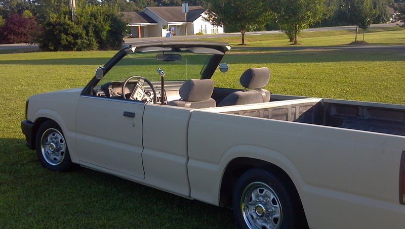

can i see some pics of people drops Im running torsionless with 3" blocks right now and i wanna cut my bumpstops and monoleaf it within a couple weeks i found a few good pics of trucks setup like that but wanna see more
topless
3" djm lower control arms, reindex torsion bars! 3" blocks 2 leaves removed ! soon to be bagged,

Topless - your truck looks high in the back for having pulled two leaves. Mine sits the same with just 3" blocks. I'm held up in the front by my bumpstops though after going two clicks down.

When the shows are !I would love to go, I'll double check the leaves pretty sure I pulled two each side been a while, n my memory not as good as it use to be!

14" better go 60 series ! Mono leaf rear you'll probably wanna do a c notch!

Torsions down 3 clicks, bolts tight to, the underside, 215/60r14s, 3 inch frame z behind the cab, full leafs, 3in blocks, load carrying shocks, flipped lower bjs, 4x4 isuzu front shocks.
If you cut your front bump stops you need to have your torsions in or in a way you have completely removed the equivalent of the front springs. even 70 series, with cut bump stops up front and two clicks on the torsions can still bottom tire into inner fender if you hit good enough. With 60 series you can clear with more of a drop up front even when the shocks completely bottom out. There are a few bolts in the inner fender that need to be shaved too or you'll gouge tire. Mono leaf banging axle into frame is not an enjoyable ride either along with riding on bump stops up front
