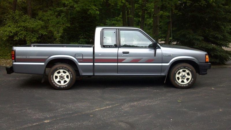

I'm going to be lowering the mazda as stock height and wheel gap bugs me So i have a few questions I'm hoping to get answered as your input is threw experience
1) Shocks.... What brand did you like for ride quality? mine are weak so the body rolls some and i like a "sporty" feeling but not back breaking. And there isuzu pup shocks front and back ones I have no idea lol
2) Lowering the front can be done many ways.... I would like to level the truck and get the wheel gap gone. so 3-4" drop should do so on stock 14's and the tires i have. Is reindexing the best way to do so ride wise and safety wise? Or should i go a different path?
3) Lowering the rear I got a 3" block set for free but need the U bolts. Any quick info on them? And at what drop do you have to notch at? I may just go to a 4" to help level the truck out.
Thanks for the help and here's a pic of the truck with the topper now off
Found some actuall rust on the truck now!!! 3 small spots from the topper Still pretty clean for a 91 with 70k miles and in WI lol

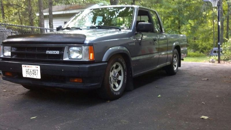

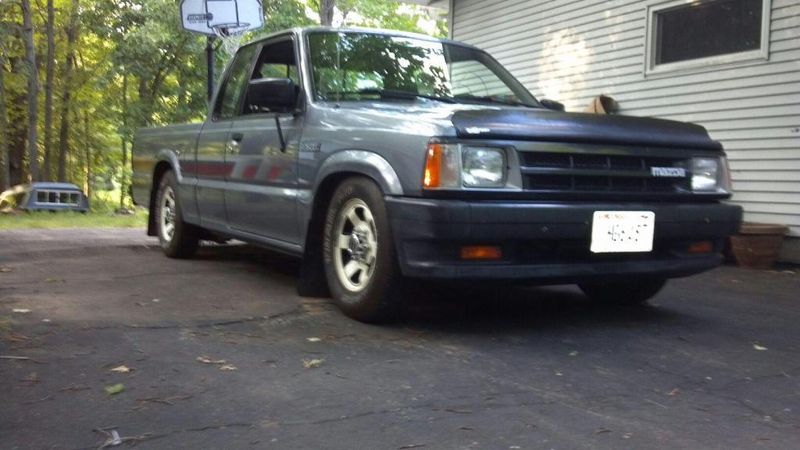

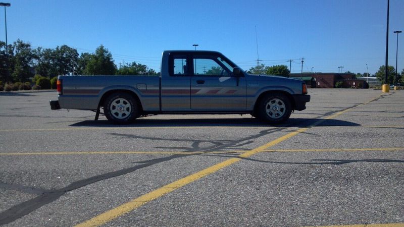

Well today i finally put in the block kit and re indexed the t/bars and threw on new shocks all around Its about a 4" drop up front and 3" blocks in the rear. I'm going to raise the front between 1/2" to an 1" before i get it aligned and switch to 4" blocks to level it out a bit if i have the frame clarence (didn't check got lazy). Over all was easy as everything was "almost" rust free and I have about 1/2 between the tire and fender at full turn currently
Pics time
I think it looks a LOT better with out the topper, Just needs some tint now, bed liner so i can use it and not scratch it, and CD player and replace the blown speaker lol

Looks great likeit is bro.

I like it too, but I dk if i can corner with it safely so i cranked the T bars a bit to get it just above the tires lol. and its nice having working shocks again! haha
OH and my mud flaps are about 1/2 off the ground.... Debating if i should just trim them or ditch them....

And quick question, the truck sits about 1/2 lower on the passenger side still and the drivers side is not maxed, but if i max the p/s its still low Should i try taking it back one tooth so its not fully preloaded from the cranked t/bar?
Because I like the height the drivers side is at! I can corner and have some weight with out worrying about it! but if i put a passenger in the truck its tucking the tire again and yeah..... I know the truck was re leveled about 5yrs back at a shop so the t/bars were not set the same before i lowered it.
