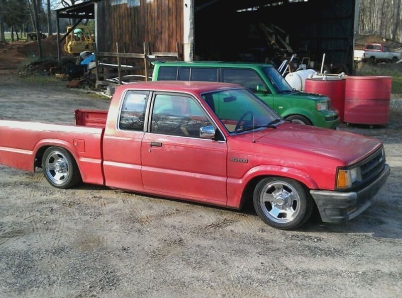

I ordered me a set of 3" drop lowering control arms and I'm wondering how u guys like them. I was gonna order drop spindles but they only give a 2" drop so I went with the control arms instead. I'm already mini notched in back and jus torsion drop front with toxics. Jus lookin for a cherry static slammed ride. I'm currently running 18s with 215/35s.
Lmk how u guys like the lowering control arms. Thanks
