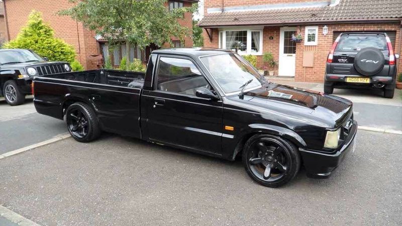

I need some advice on shortened shocks for my truck from people with experience with B's.
I bought it already dropped so I don't know how
much it's been dropped, all I can see is that the chassis has been notched.
anyway here's a pic for reference
wheels are 17" and front tyres are 215/45 and rears are 225/45 if this helps.
cheers, james

My tires are my shocks.I am running kyb in the rear and there compressed and they hold up and there cheap.You dont need anything fancy on a b .

I'd say isuzu pup shocks up front, I used jeep j10 shocks for the rear on my old b22 that was 3 in blocks with main and over load springs in the rear, and had a small axle notch.

mazdaron - roads are shite here in the uk... I can hear the shocks bottoming out all the time
and what is an Isuzu pup..? we don't have anything called that over here...

Isuzu pickup. Pup is just short term for it... Look for light duty isuzu truck shocks... Early 90s. I used a set from a 4wd cause they had a little more weight capacity than 2wd versions...
