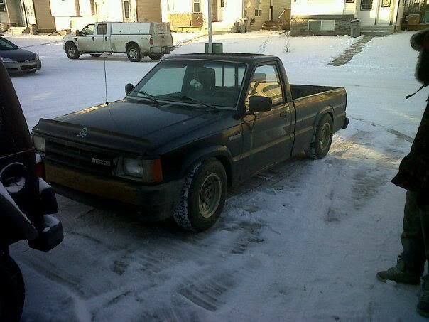

Had it jacked up, WD-40'd wratchet and a cheater. Drivers side came out no issue. Those are the breaks I suppose. Soon as I get paid and come back to town ill have pics of where she sits as of now. I'm actually pretty stoked cuz it already looks lower than my old d21
