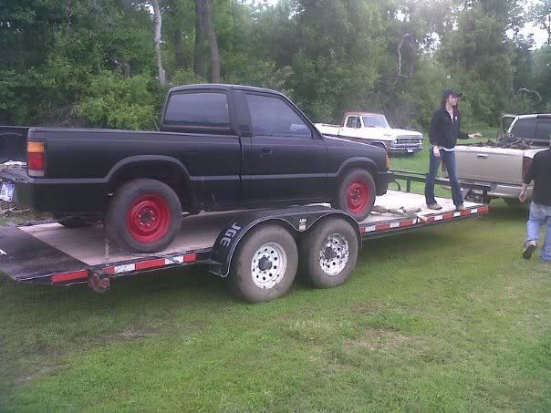

Well i finally got my 1990 b2000 home. The body is immaculate, flat black, red painted rims, and a drug rug intereior (mexican blanket).
You may be able to see a motor poking up out of the back of the dodge, that is the 5.0 and AOD trans that will be going in this pickup. I made a post previously about my lowering plans but i acquired a set of 4" lowering blocks for free. I heard bad things about 4" blocks, why is this? would 4" get me really low without pulling leafs? I plan on new shocks all around either way. Then to match the front should i just crank down the torsions? Ive heard of people removing them altogether, is this okay? Last question is, will the added weight of the v8 lower it much where i shouldnt worry about flipping ball joints?
