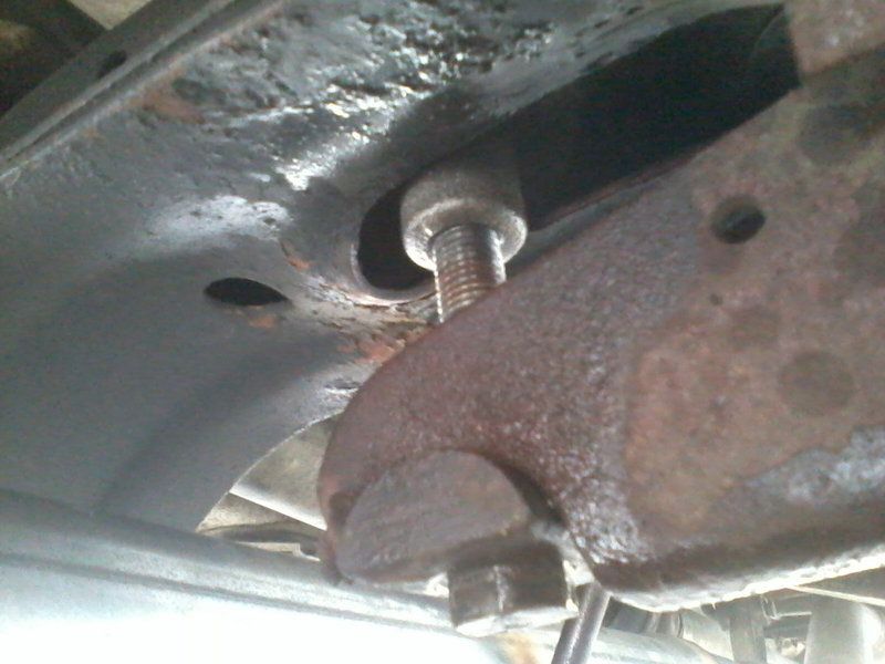

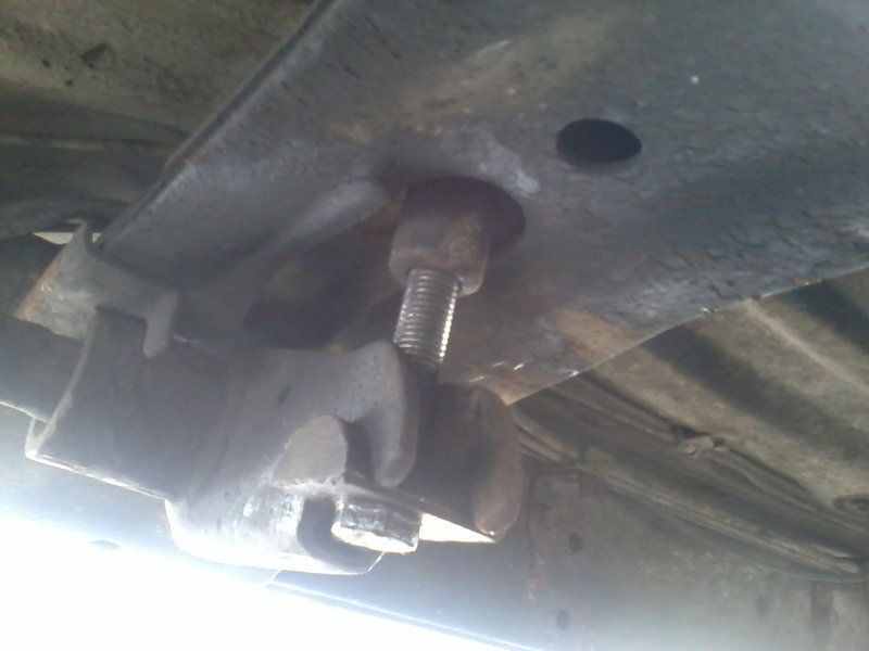

so im cranking the bolts on my torsions to lower the front, as im doing this i noticed that the nubbin that the bolt actually threads into sits further out on the passenger side than the drivers side... whats up with that?
its not level

1hotdawg's avatar
1hotdawg
One of the t-bars is not in it's "groove" on top of the frame there most likely. They turn some times when being adjusted, so whoever lowered the truck before may have allowed it to turn.
addiktion's avatar
addiktion
is this a problem? if so how do i fix it?
1hotdawg's avatar
1hotdawg
When you loosen it enough it will be able to be turned by hand. It is only a problem if it slips through the opening there...and yes it can do that...been there done that
You can reach your hand up there and tell if that is the problem or not...compare the two sides. The T ends should be pointing forward or backward, not towards the center of the truck. Now, if it hasn't actually turned, it could just not be in the groove...again once you loosen it enough you'll be able to place it properly.
