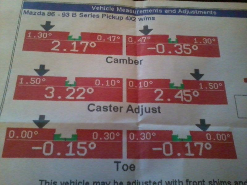

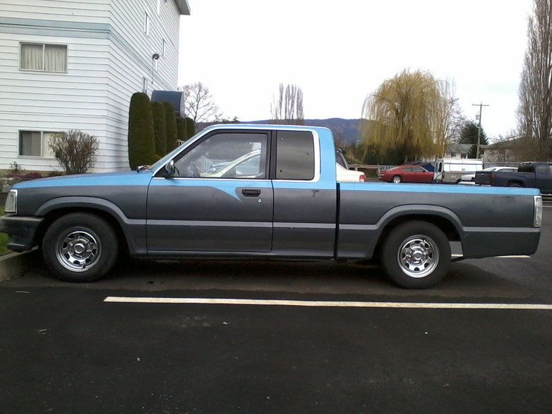

so i brought my truck in to get an alignment and i was told the camber, caster, and toe is all mangled. right now i have the front and back relatively level. i still want it to be lower in the front and back but all ive got left to do in the back is de-arch the springs. then id have to tweek the torsion bars again to get'r level. so do i want to wait and get that done before i do the alignment or should i get the alignment now so i dont eat up my tires and then when i do lower it all again go back and spend another $80 for another alignment? the back has 3" blocks and only two springs left in it with no bump stops. also do i want or need drop spindles for the front?

My camber looks about the same. I wonder why it's set up like that. My toe was straight jacked up though. I told them to fix my toe so I could track straight down the road.

ya no doubt, my tires are just used anyways so im not too too worried about them but i mean its still $100 to get new ones so i dont wanna wreck them if i can help it. i think i am actually gonna leave it at the height it is and just get the front and back perfectly level when they do the alignment. im gonna leave it up because my roads around here are shit lol. other than that ive got one more stupid question... does it matter how low my truck is before i bag it?
