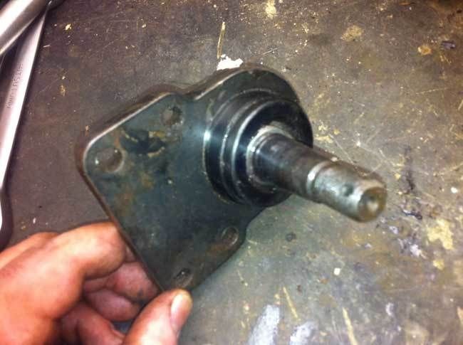

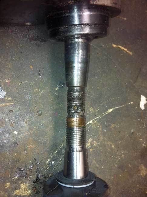

Just about to mount a couple of dropped spindles i bought here on site, but now that i got it in my hand i can see a difference in size, and my new balljoints wont fit !!
So Q is, are there different size of balljoints for original and dropped spindels ??
The BJ that was in the spindles look some kind of homemade !!

they are different thats why they come with them.
hunterw's avatar
hunterw
Yeah the drop spindle is made to take the balljoint it comes within the plate. If you are looking for new lower balljoints hit up sadistic. He has a personal set he is selling. Though not sure what shipping to denmark will cost you if I remember right its a s10 lower press in ball joint

Okay.. and its only the lower that is speciel ??
If its s10 then i can just install s10 BJ's in the plates that was with the spindles ??
hunterw's avatar
hunterw
Yes only the lowers. I would take the balljoint and plate with you to an autostore and see what they say too. You'll have to have the old bj pressed out.

Thanks.. Have my own hydraulic press so no problem there.
Ill get hold of a couple of s10 BJ's and see if it goes in
