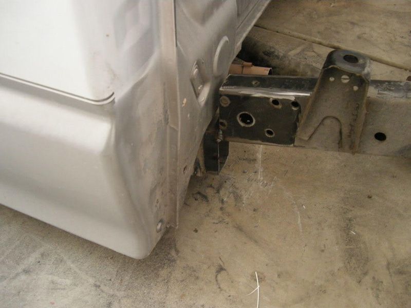

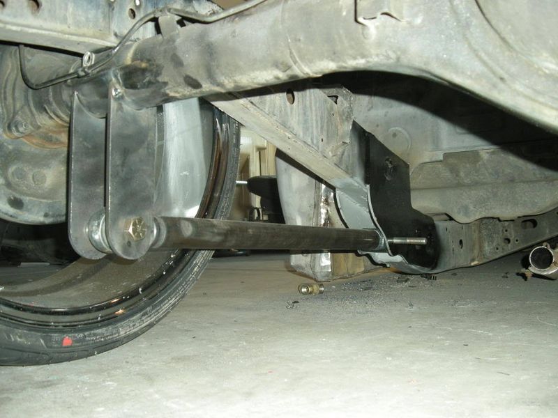

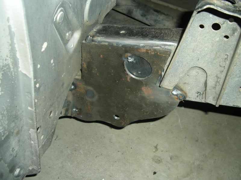

Gonna start Z'ing the rear end pretty soon, been reading up a lot and a lot on it. plan on doing 2" or 1 3/4" so I can have a place for the four link bars that will be happening soon as well
my inspiration and a good bit of studying came from Tre5's build and pictures
should i use 1/4" steel for the brace?

dam man ya that is looking good i would use 1/4 but some say it may be overkill.

Rather be over kill than have the frame twist or snap on you 1/4 is the way to go

And to add to my previous statement i have read on many forums it is better to use the 1/4 inch on z's and notches for the strenght then to use anything else
so yep you right v8

fo sho 1/4" all the way for me

In the pics above the only thing I would have done is make the plates longer and box the frame on all 4 sides
