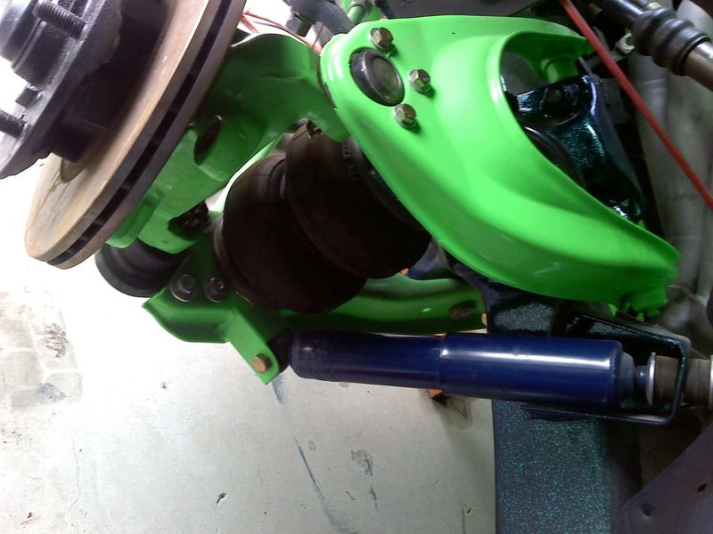

i need some mazda help i got a 88 b2200 bagged with 3" drop spindles on the front can someone take a picture how the break calipers mount i think im missing some parts from my tear down. and if you can give me any input itd be much appreciated.

this is what i got yeah i looked there two inchers. the caliper hits the rotor its like im missing something

i just installed mine with no problems, callipers bolted back up fine.
just line it all up against the old spindle if you have it, but in reality the calliper can only go back on one way

is it hitting the front or the back of it, i had to put washers in there to keep mine off the rotor, it was hitting the front
deanmiller412
the problem is there is about 3" from where the caliper bolts in. cause it hits the rotor. i dont have any of the old spindles and its been 4 years since i took this apart so i have no idea how it goes anymore.

no worries, i took some pics on the weekend of when i did mine, if you can wait i can post them tonight.

sweet thanks thats what i have been needing i was gunnu run to the junk yard and try to find one and rip the whole front end appart to see how it goes.
