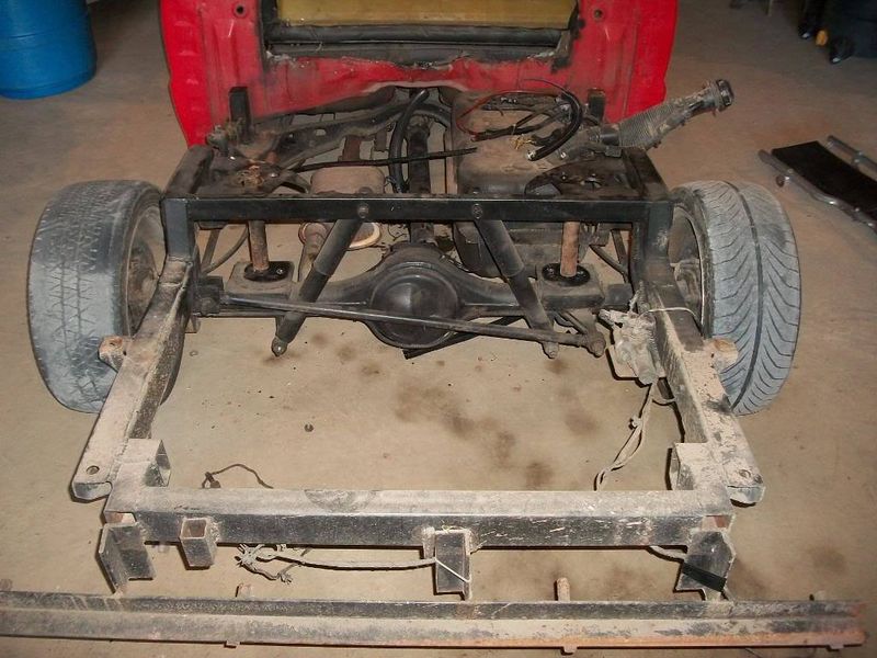

I was told, the brake proportioning valve over were you would c-notch the passenger side, could be removed. any thoughts? moved or removed?
immortal1 (linn)'s avatar
immortal1 (linn)
For most of the installs I have seen and for both of my trucks it has been removed. Brakes still work fine.
yup you can remove it
shrobs187
take that ish out
V
v8mazda4ever
you can move it aswell
splinter's avatar
splinter
would you have a light on dash from removing?
mazdaman82's avatar
mazdaman82
no.. i never did, i removed mine
splinter's avatar
splinter
did you cut the stock line and splice a new piece in there or did you bend it somehow? thanks
twitchvoodoo's avatar
twitchvoodoo
ok crack a beer,look at the valve...loosen the line that comes from the front of the truck from the valve,, next loosen the one that comes from the axle from the valve.. now take those two and connect them... unbolt the valve from the frame and chuck it in the scrap pile.. bleed brakes and then done..
