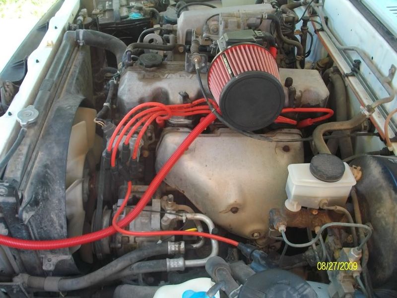

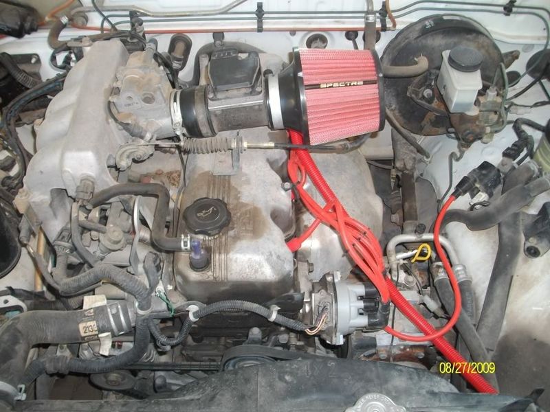

So far we have moved all the intake crap, but that is it. You also said you needed to keep your emissions so I don't know if the way we did it will work for you. Some people think we are sucking in hot air, but I don't think it makes much difference.

I have to agree with the "some people". With the radiator fan blowing and the exhaust manifold running hot I would say your engine IS sucking some pretty hot air. A better option would be to route the air filter somewhere in-line with or in front of the radiator. An infared thermometer would be handy for finding out the actual temp drop between the current filter location and an alternate location.

My point on the hot air was that everyone runs these chrome plated metal tubes from wherever they get their "cold" air from. To me the metal is going to absorb all the heat and dissipate into your intake air anyway, so in the long run it probably doesn't make much difference to the actual air temperature.

At idle, very true. Air speed thru the tube would be slow enough that the hot tube would transfer some heat to the air. On the interstate with the motor running 3,000 RPM (or at least thats what mine usually runs ) then the air speed thru the tube would be high enough that the tube "should" transfer very little heat to the passing air.
