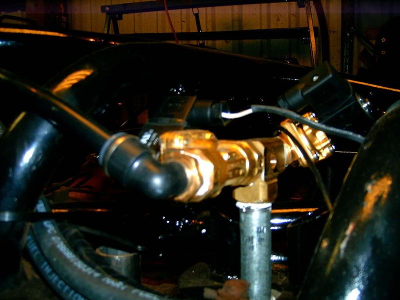

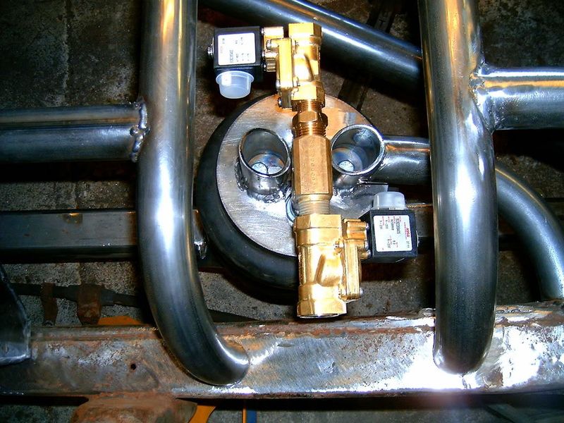

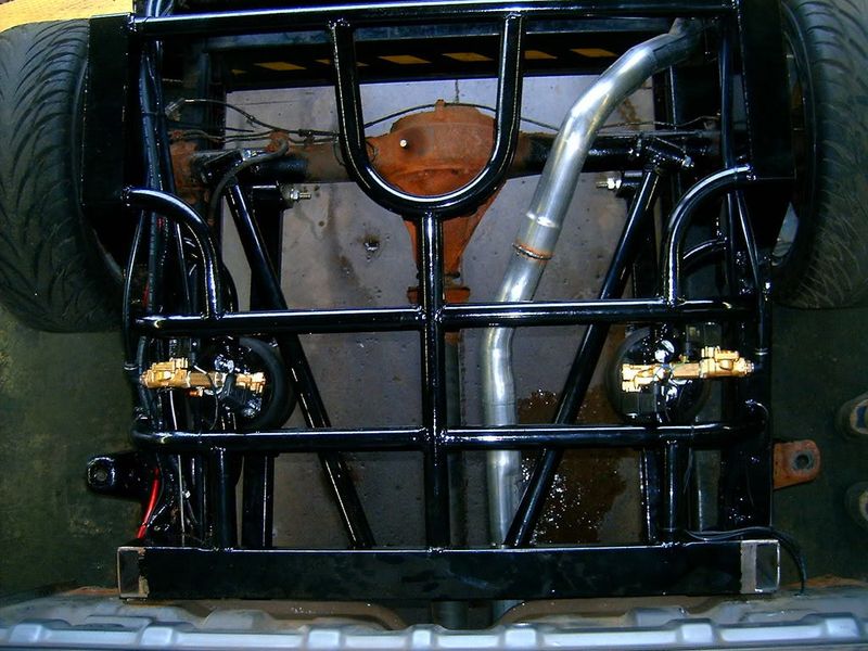

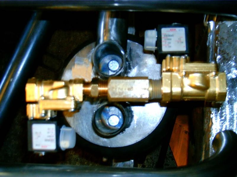

here are some pics of cids truck i did this is one way you could do your baack valves over the bag
Hope this might help you out

lance he has a manifold... those pics are great but not going to help him
