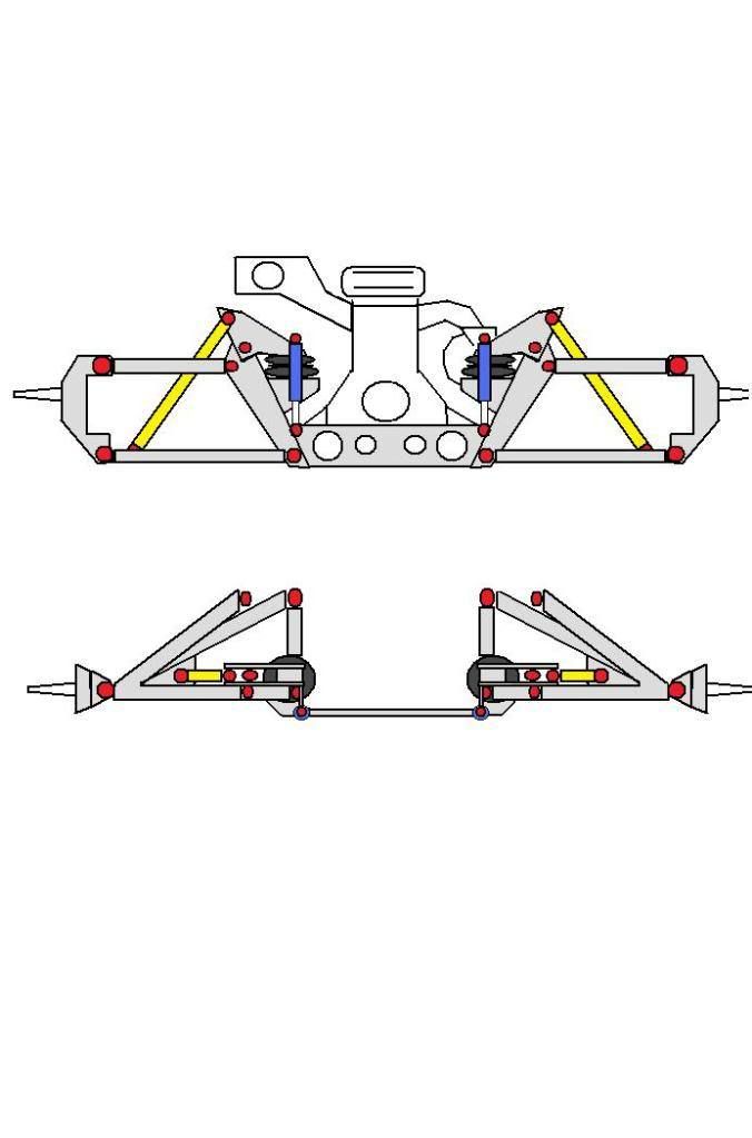

push rod F1 style, bagged of course the red circles are the pivot points
skrapinsask's avatar
skrapinsask
Damn, you did that in ms paint didnt you! How would this be located around the engine?
Looks sick!
mazdamandan's avatar
mazdamandan
yep, ms paint again, lol
front clip would be narrowed some, and, the ucas are not symmetrical they are flat on one side I will do a top down view.

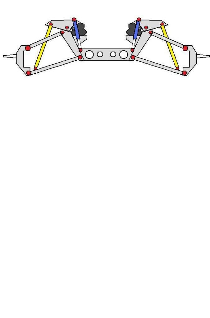

tricky to follow

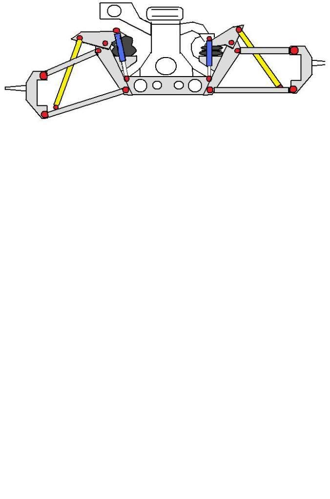

lifted
mazdadropped
damn that is some clean looking work wish i could use paint that good

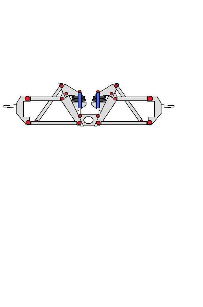

man thats pretty sweet.... would be killer to see it actually put together and working

I may do this yet, I dunno, I am not happy with my current set up, It would all be heims= expensive
I wanna triangulate my lowers, and rebuild my uppers anyway sooo.............

I would use chromoly for the arms too
