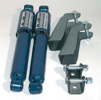

The easiest way is to use a shock adapter at the top rather than a fragile extender.
: about 30.00 then you can use a more common shock with loops at both ends

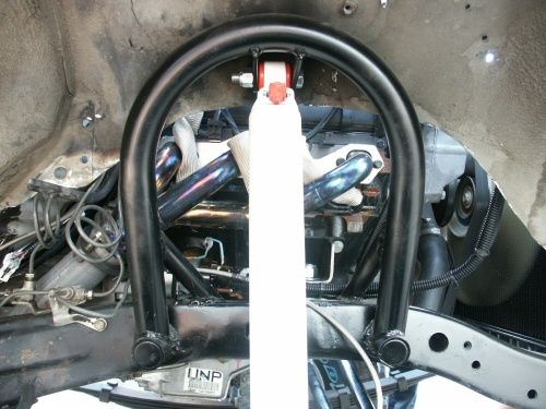

That is totally opposite of that the post stated at the start. you will need to make shock hoops for the inner fenders like these

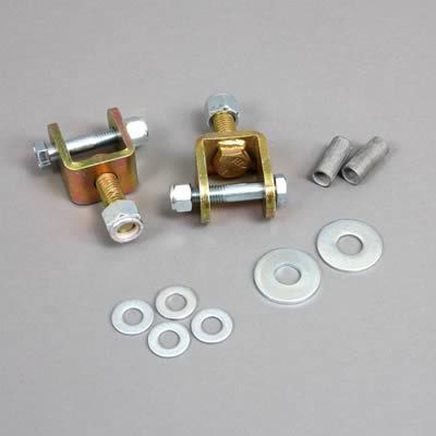

that or a shock relocate kit and use the top piece in place of the factory mount.

that's the plan, just want to see some pics of it
