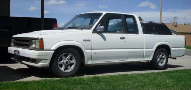

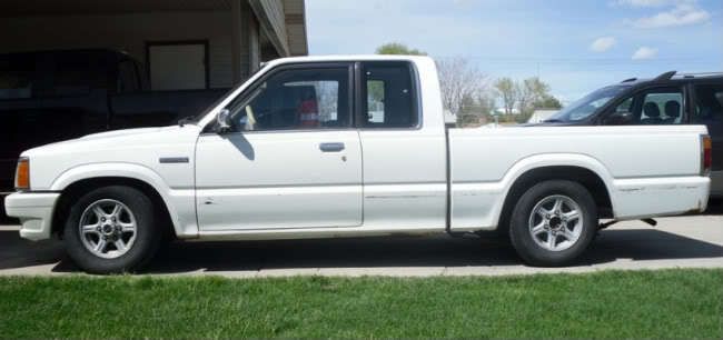

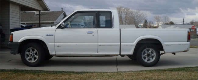

I static dropped my truck today. It's just a moderate drop since it's my daily driver for work. It's a 3" drop in the rear and a 2" in the front. I cranked the torsion bars instead of re-indexing them because I couldn't get on of the bolts off...it's stuck good. But the torsion "hooks" don't hang any lower than the exhaust, so I should be ok. Anyway it looks alot better now. I might take one leaf out in the rear when my drop shocks get here.

dont look that bad besides the monster truck tires. lol.

looks good man...ahh the memories, I can still remember when my truck had that kind of drop on it, for about a day and a half then I dropped the dog snot out of it, lol. Definitely need to look into some smaller tires though

Looking good man. Nice start. Like you said, drop shocks and take a leaf out. OR you could run blocks; 2"~3" is about what most people run.

The rear has three inch blocks on it in the two lower pics. It's not low enough, that's why I said I'll take a leaf out when my drop shocks come in.
Thanks for the comments. I plan on getting a little smaller tire soon, but not too much smaller. The rims and low pro tires will have to wait a long time...I'm going to swap the axle and control arms to Ford Ranger stuff. That will be done when I get the new engine, trans, ecm, and harness... so I have to save quite a bit of money first. Until then stock is in.
