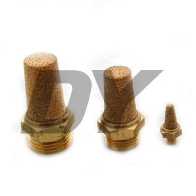

i have a couple good 3/8" valves for sale and a good way to keep it smooth is to limit youre air pressure to 130-140 with out shocks but with shocks you could do 200 and it will still lift very nice , and as for down just get a brass filter i use those and they cut the sound a hell of a lot and slow it way down

what type of brass filter are you refering to?

if you ask for brass silecers i get them from a shop here in town that i get my fittings from just go to a semi truck parts shop they will have them they make it way quieter and slow id down pretty good to
