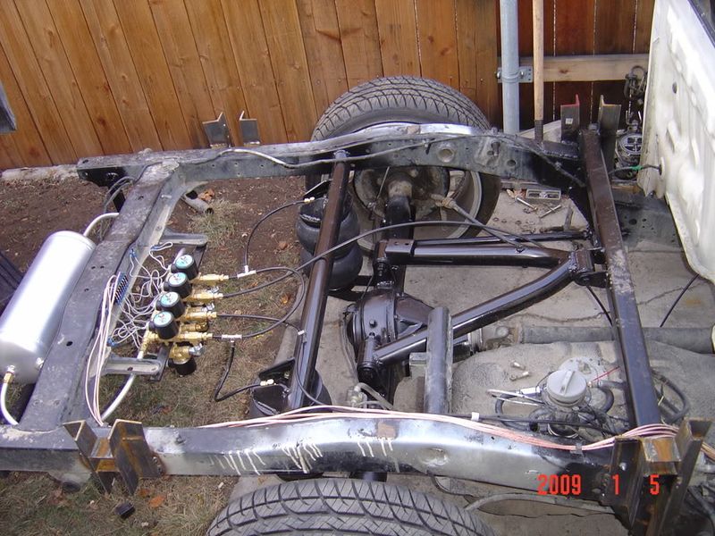

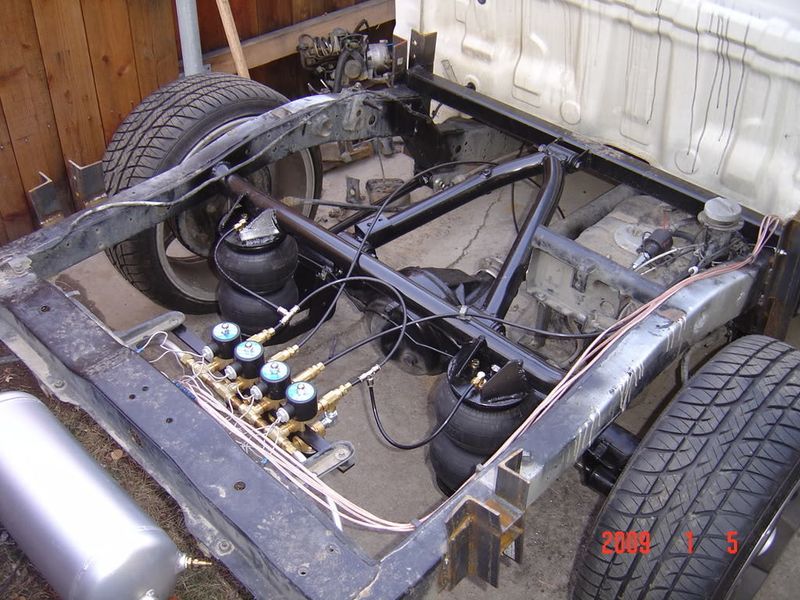

droppedmydawg
Here is a pic of my rear setup. I am going to have a new wishbone built this spring. I just don't love the final product on mine. It is straight and true though.

beatmymini
how did you get your bags to lift and drop so slow?
90-b22dawg [andrew]'s avatar
90-b22dawg [andrew]
it depends on the size of air line and valves you use. also theres flow controls that can be used to slow the air down. if you do some digging around in the build threads you will come up with a BUNCH of pictures of different types of set-ups.
justin--- i have an idea in my head (not for my truck) to do a single bag catilever set-up but it would have two arms off the bag. one going to each side of the axle (maybe even on an irs rearend) that would be sweet looking.
droppedmydawg
Yeah, what Andrew said. I ran 1/4" line and 3/8" valves. I know a lot of people run larger and like the speed hops of fast air systems, but I wanted smooth control and less stress on my frame and suspension components. Not that others are wrong for wanting those faster systems, it is just not my style. I also was planning on getting pulled over for ride hieght infractions and figured the less obvious my truck moving up is the better. I have yet to be pulled over in it though. -Ed
