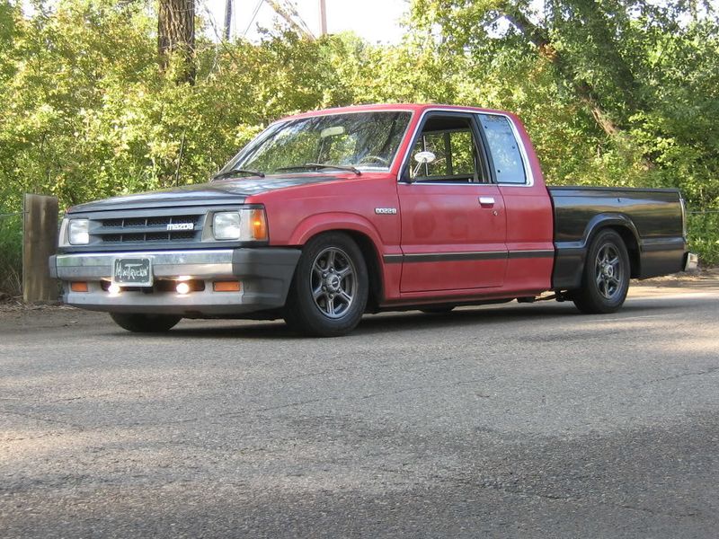

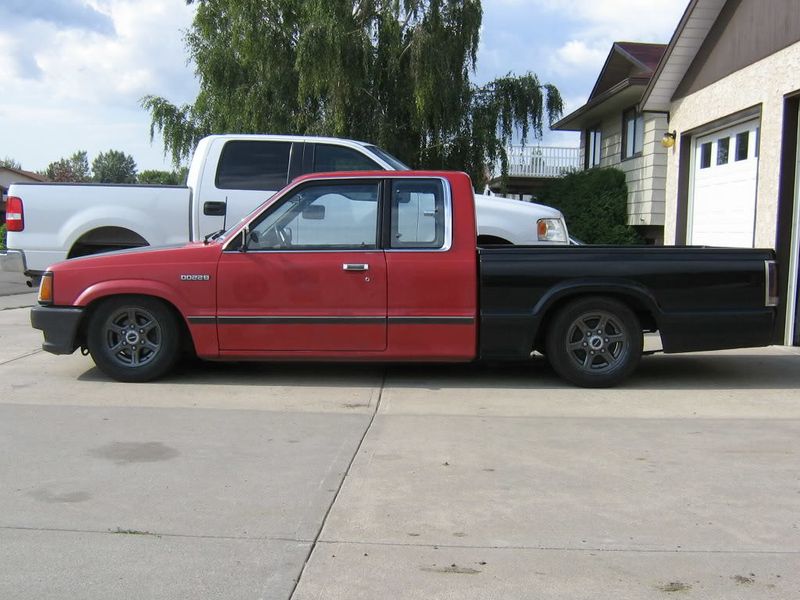

This is on 14s with reindexed bars and 3" blocks
