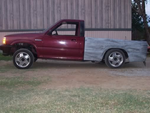

Believe you would have to notch into the frame rail.
j$c
If i go with re6's will the frame have to be notched? I know i ill have to trim the lca, no matter which bags i use. Thats no big deal, but i'm wanting to keep from cutting in to the frame up front, if i can help it.
thanks...nice lookin truck btw
