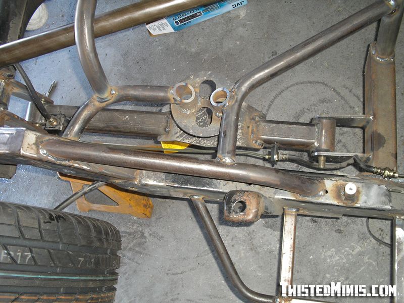

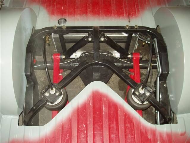

how is everyone running the rear brake line with bags?

i know alot of people are running it attatched to one of the lower link bars.

elbine69's avatar
elbine69
Thats the best way to do it
jsulen
We usually run the hard line to the front of the notch, then cut it and re-flare it. Run the rubber hose from the axle to the hardline and mount the T where needed. Then just run new hardlines on the axle. Brake line is dirty cheap so it really cleans things up to make a nice job of it instead of just making the stock axle lines work around whatever brackets you add.
