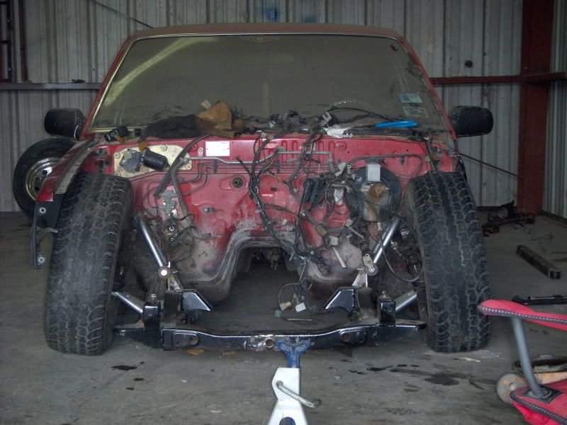

Im running cando upper and lower arms with a yota spindle. the frame already lays on a 26.5 tire except when i try to put in a re6 bag it wont work out. The bag runs into the lower balljoint,should i go to re5's or will drop spindles fix the problem?

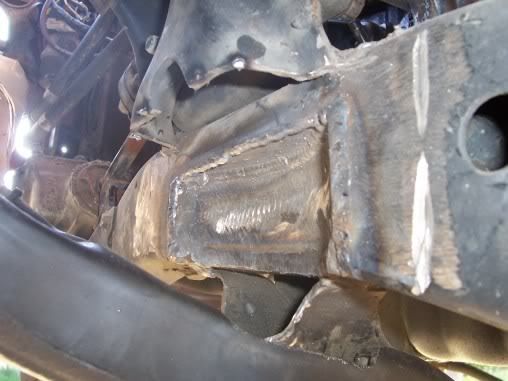

cut the bump off the frame and move the hole in on your c arm you can also cut out a pocket in the frame but you have to plate it back up
elbine69's avatar
elbine69

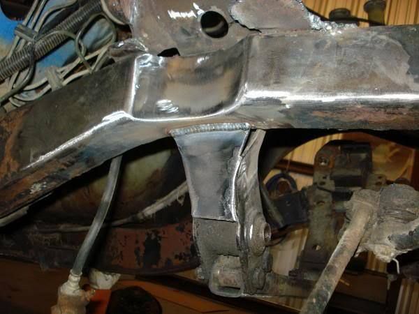

Might have to notch the frame like this:
You can fit re7's by doing that with stock mazda parts.
suicide's avatar
suicide
i fit re6's in the front of my mazda with all stock mazda parts and i didnt have to notch the frame. but if you notch the frams you can move the bag further in to get more lift.
