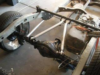

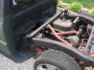

only a couple of ways to keep stock gas tanks and they require you to fab the link/bars and the lower front mounts....
you can do either of these.... both of the following have their rear section zed instead of notched... much clearner look and no holes need in the bed ...
or
