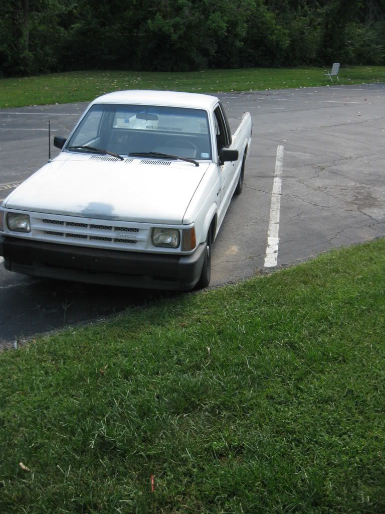

Alright i have never noticed. but my left side has some camber into it after i dropped it but the Passanger side don't. i been hearing wheel squeal on left turns but not right. could this be index the torsion bar wrong? i did cut the bump stops and make sure they a where even

Alright well its way to hot outside to do it right now. and also the steering wheel is a little to the right

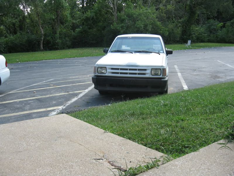

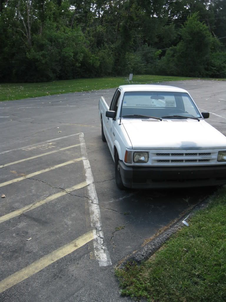

Here are some photos

Front end is out of alignment, got too much tow in the front end, an alignment shop will take care of that for ya. As far as the camber, only way to get rid of it is with spindles or some cuttin and weldin!!
cameronb2600
He did mention that the wheel was turned. The only true way to determine if the alignment is out (unless it is completely whacked) is to get it to an alignment shop and have them check it. An alignment wouldnt hurt, but I would think there is another problem in there causing this.

yeah he had the wheel almost straight, and didn't move it between sides, mine was like that but worse till i got the front end aligned, prolly wouldn't hurt to redo all the bushings and everything in the front end either, considering these trucks are old and still have mostly, original parts, lol
