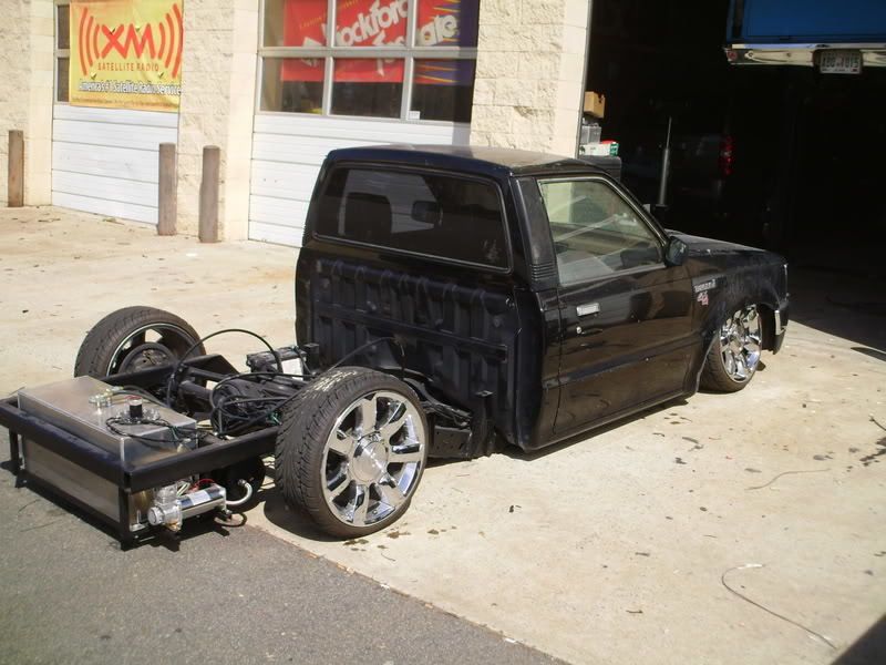

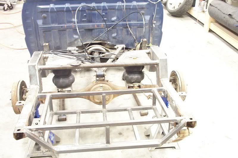

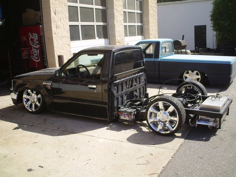

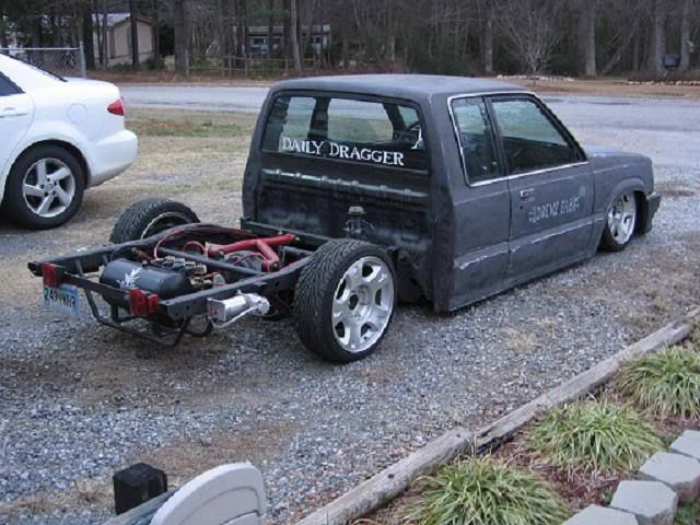

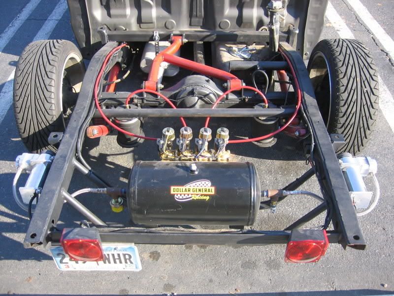

You could run a standard cab tank and relocate it to the rear.That's what I did on my 88 and built a cage to protect it. A fuel cell would be ideal.The bottom pic is of the 92 I did.

I backhalved the frame on the 92.I cut it off behind the second bed mount and built new rails.

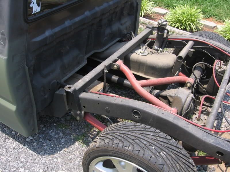

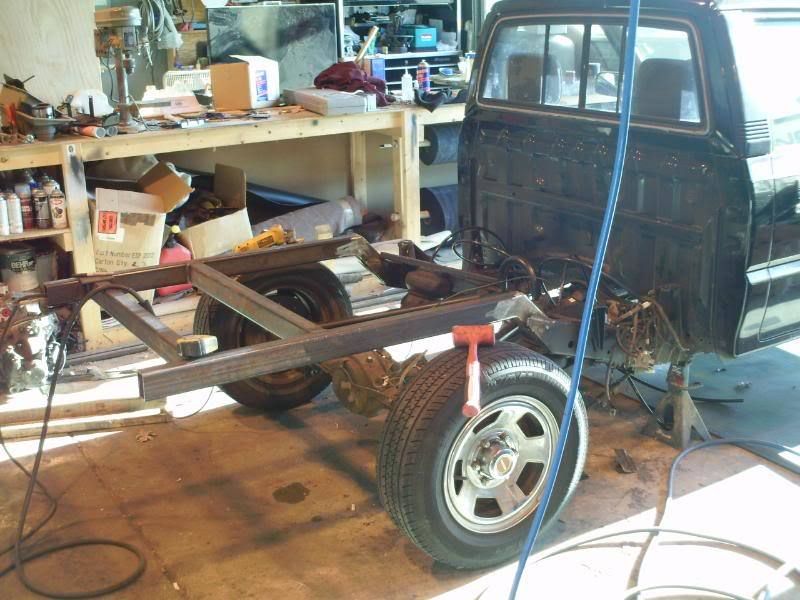

Originaly we did a regualr notch but chand=ged our minds halfway through and cut the rails off. Here is the original set up

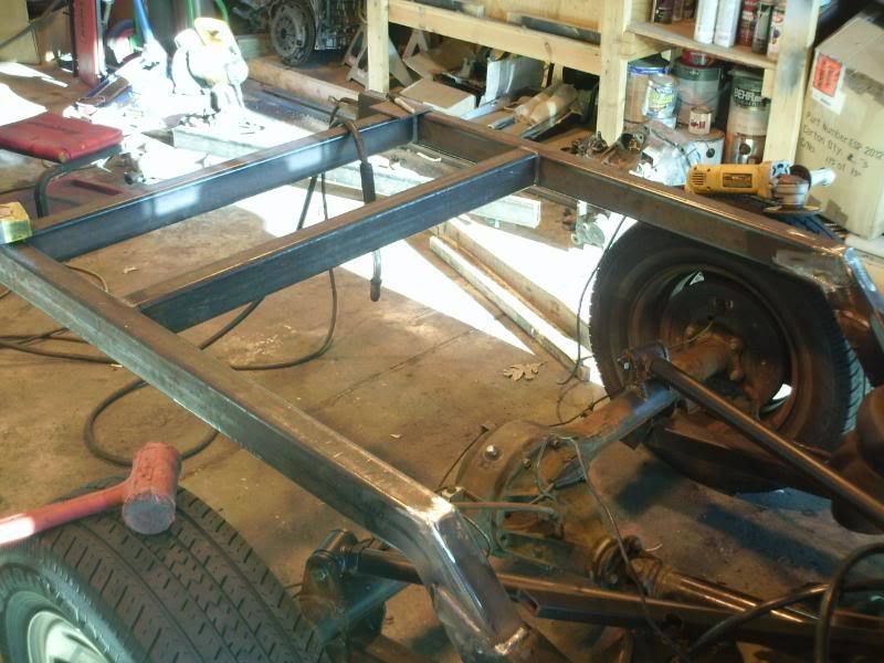

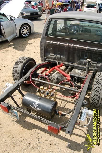

you can raise the tank and get some clearance from it. mines raised in the stock location and its all good. take the front tank tab and put it on top of the bracket and build a new bracket for the rear of the tank. i did an upper wishbone off to one side and bag behind the axle to keep all under the floor. also that left me room to mount compressors and tank at the rear of the truck.
cameronb2600
Do you have a picture of your rear setup, just to get some ideas from? That would be awesome! Thanks
