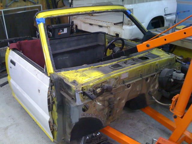

well here is what i did to mine.
here it is cut out
and i put trailer fenders in it to make it looke a little nicer
you can see the blower motor
it lays out on a 235/40r18 with some room to spare. so if yours is just lowered you wouldnt have to cut it out that much
