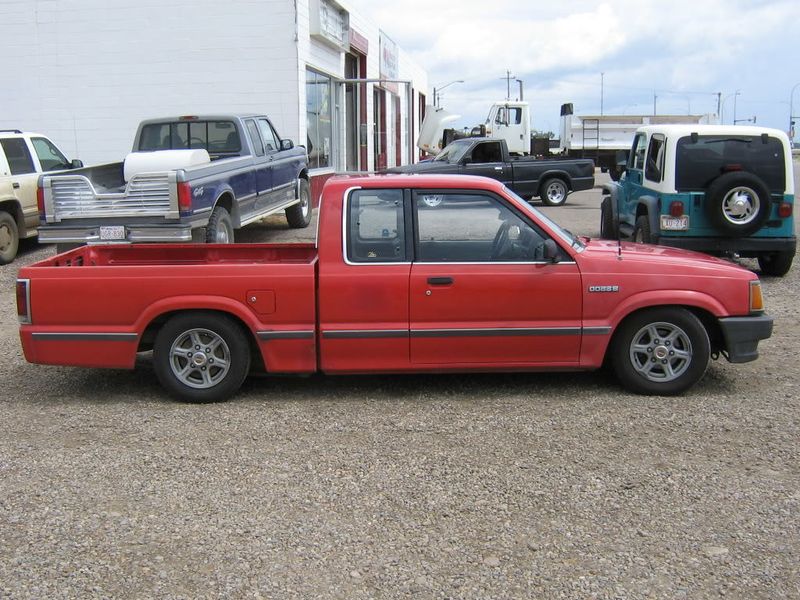

I have 3" blocks in back and all the factory leaves and i've got an inch or less of clearance at the bumpstop. I think my leafsprings are old and sagging. I plan on removing at least one leaf shortly, but did I understand you guys right? It is better to remove all except main and overload?
Here is how it sits right now....... the front is about an inch lower, but gonna re-index and flip the ball joints shortly........ Please don't laugh too hard at my hoopty!

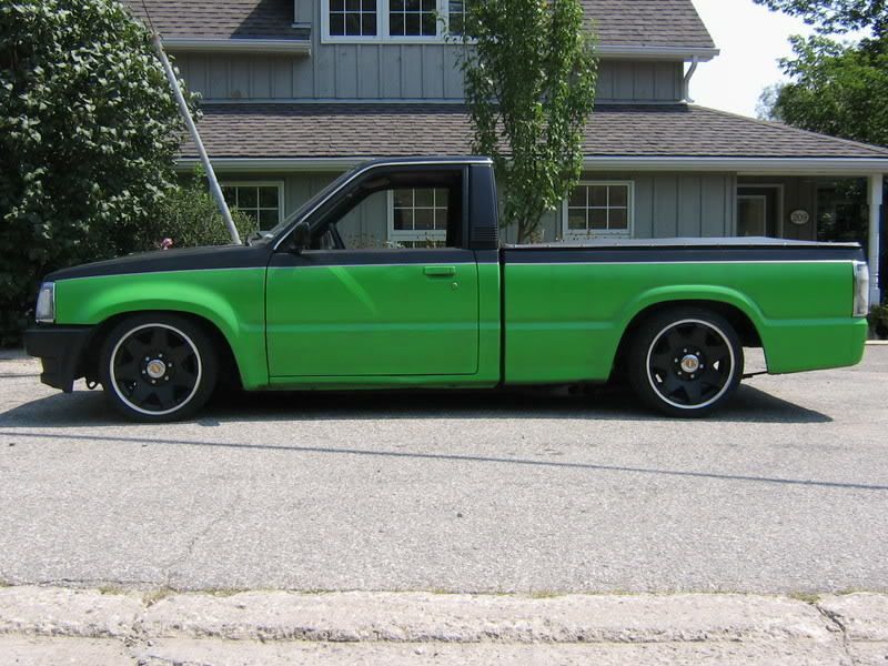

3" blocks and just the main leaf and overload. 14" wheels with 205/65/14 rubber. Have maybe an inch of travel before I bottom out.
Same setup, but with 205/40/17s
