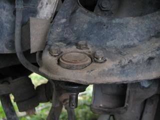

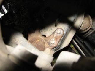

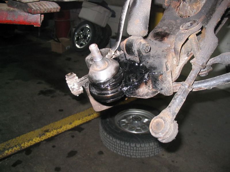

So many people ask about flipping balljoints, so I thought while I was dropping my truck again today, I'd get pics for the newbies.
Upper Stock
Upper "flipped"

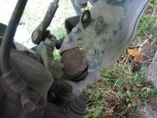

Lower stock, (except it's already had the hump cut out previously)
Lower "flipped" sorry this pic isn't better I'd almost forgot to take it.

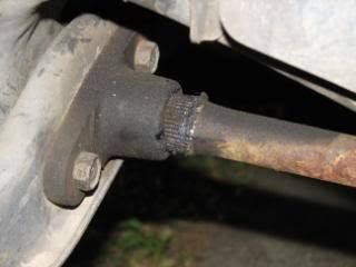

Oh yeah, and here's a pic of the torsion splines. You'll notice I marked mine with a Sharpie before adjusting.

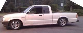

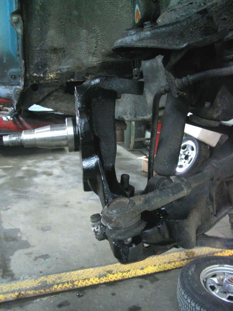

My results from an afternoon's work?
From this
To this

How much lower will flipped ball joints alone make the front end? And does it work the same as how a drop spindal does? Just by lifting the spindal hence lowering the ride height? Thanks heaps. Nick
sierrax
I would say that it makes about a 1" to 1 1/2" drop. I don't fully know because I ran a spindle along with the flip. After I did mine I used a 16" wheel. Since it does split the two control arms apart, I don't know if you can run a 14" wheel.

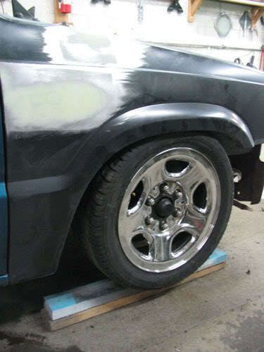

The flip I did isn't that "flip" lol. I've done that before, but it wouldn't work with Pathfinder wheels. I thought about doing it like that now though with my 16" Chevy wheels. Just kinda was worried it was safe or not. You do have to retaper your spindles like that as well though.
I just did the "small" flip, as in just put them on the other sides of the control arms, but faced the same stock way. This gives you only a half inch or so.

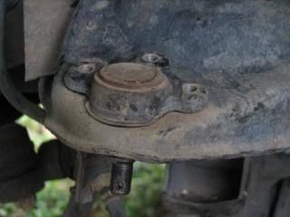

The spindles that I had were already tapered that way. As far as safety, it is the same any way you flip the ball joints. When stock the Ball joints force goes through the four bolts supported by the control arm since the BJ is under the arm and it points down. When you flip it like in the original post pics, the BJ is now on top pointed down so the force goes just through the 4 bolts. The same goes for the way I did it, BJ under the control arm but it faces up, so the force only goes through the 4 bolts.
I worked great for the 2 summers that I had it like that with no problems.
With the spindle on.
This is the what is camber and everything looks like with the wheel on.

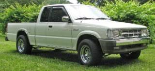

Currently, I have 14s and my torsion bars cranked and this is how it sits. No bj flip and no spindles. I don't see why I would need to flip my bj's at all. Even when I go to reindex my bars, it will sit just as low but without the bolts hanging down in the danger zone below the frame. Tires are 205/65/14
Monoleafed, 3" blocks and cranked bars. That's it.
