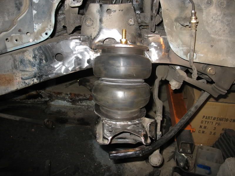

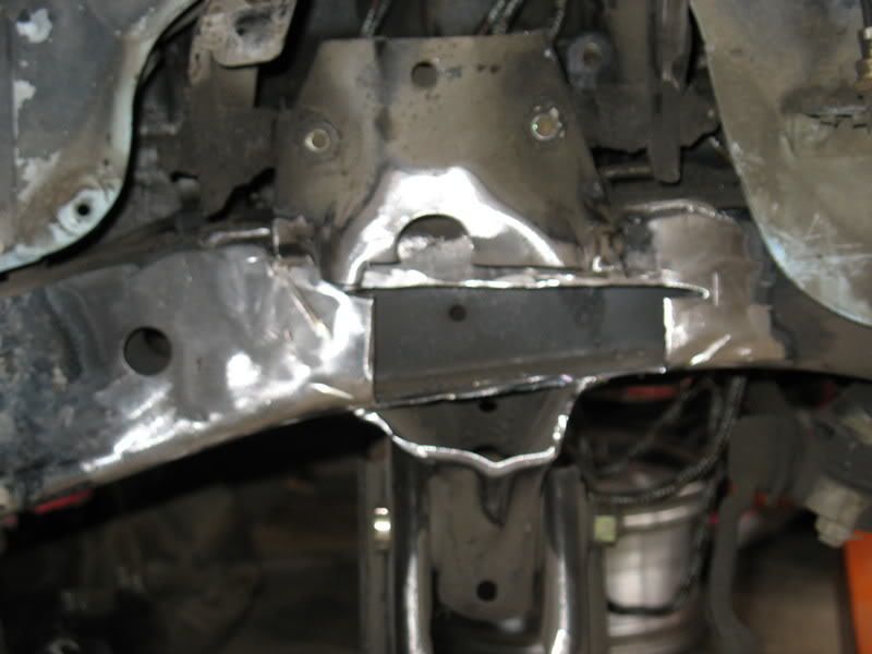

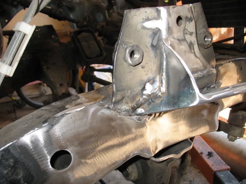

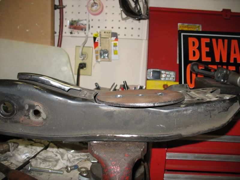

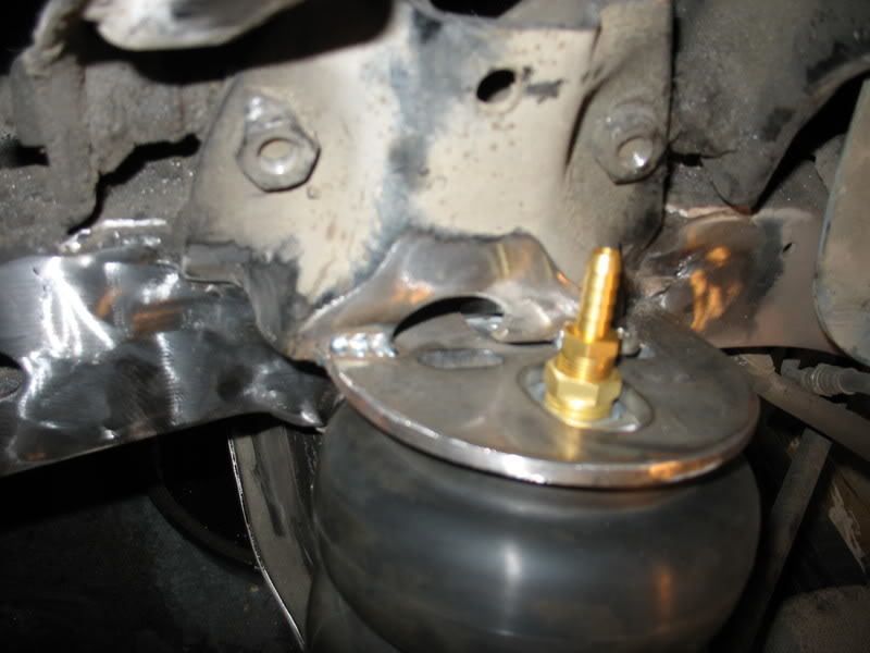

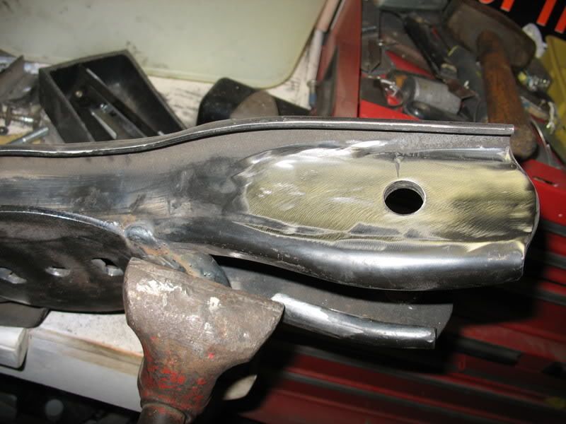

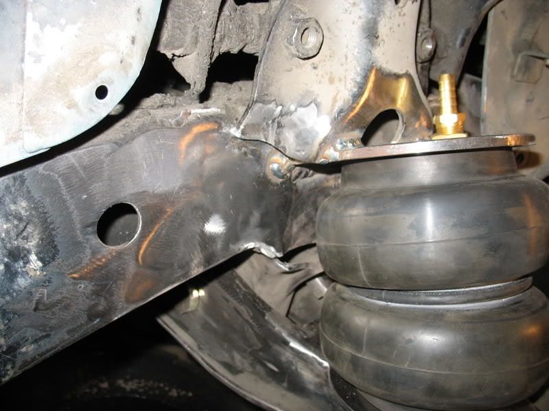

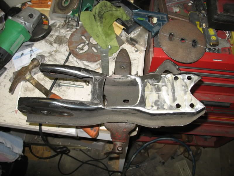

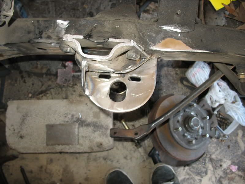

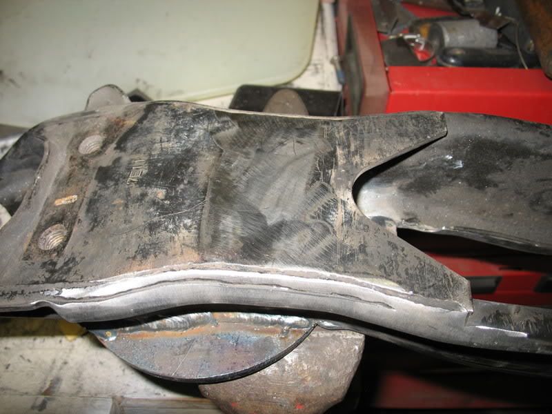

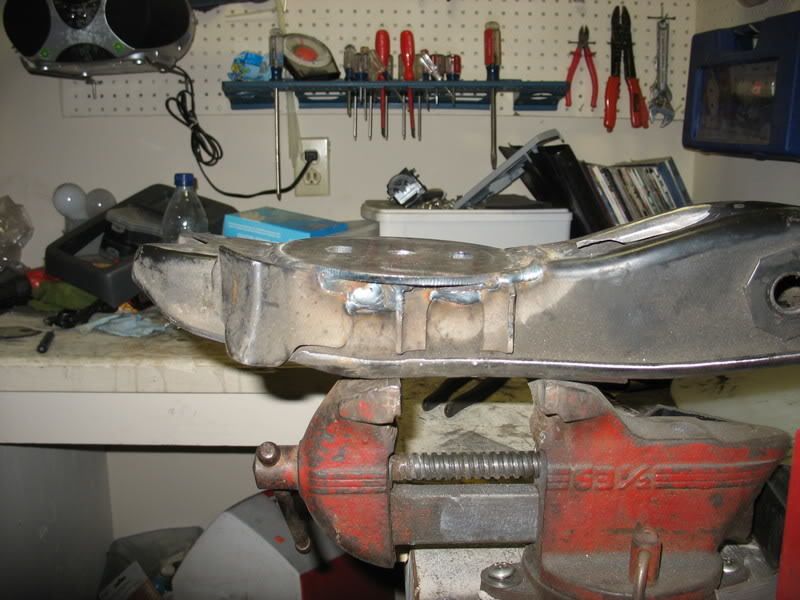

Is this what you mean? The only reason I notched mine were to lay the bag at a different angle and move it into the frame for more lift. As seen I also notched the frame for the bag to sit inside of when laid out. Josh on here also did the same mod (but his looks better) and he lays out on a hella big wheel.

yeah, thats it. ok thanks i just wanted to double check myself lol.
thats all i needed to know haha thanks again.

is your bag completely collapsed when laid out? maybe it's how far away the bags are from the frame. My final wheel and tire will be the same as yours, but I restrained mine from lifting all the way cause 3" wheel gap with a 2" body drop was all the more I would want.
dragn37
no thats the thing, i think i have to redo my mounts, becuz my bag isnt fully collapsed..
soo any tips/ideas?
1. bag close to frame as possible without rubbing ?
and how high should i jack my tire up to see where to put the bag? that just confuses me

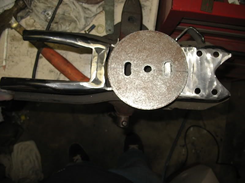

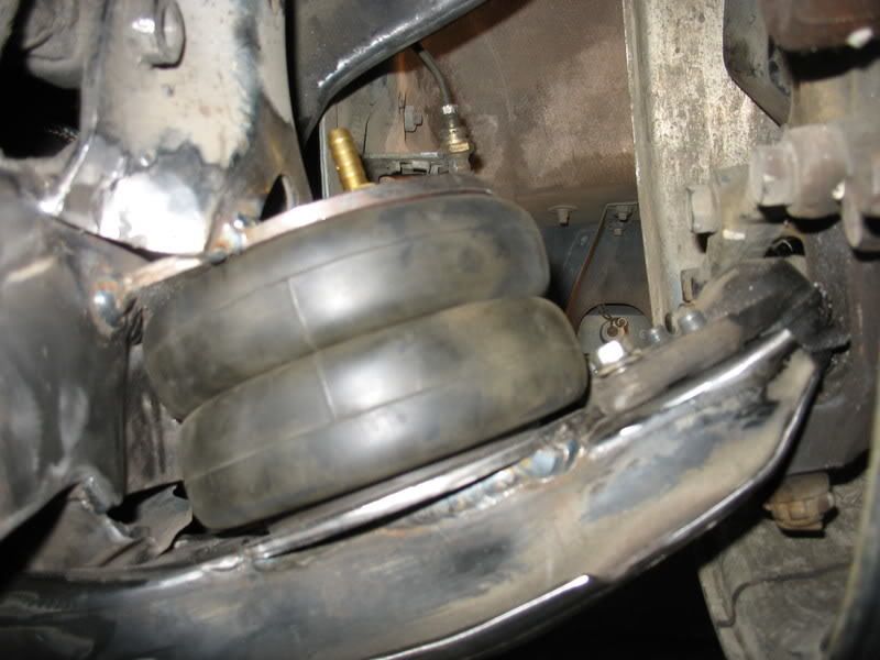

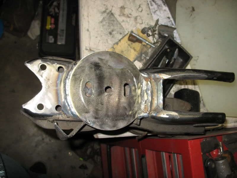

As requested here are all the pics I have.... Also I am using Slam RE -6's up front.
The Bottom is now smooth...this was an older pic
What it started out like

damn those are nice lookin arms jeff!
