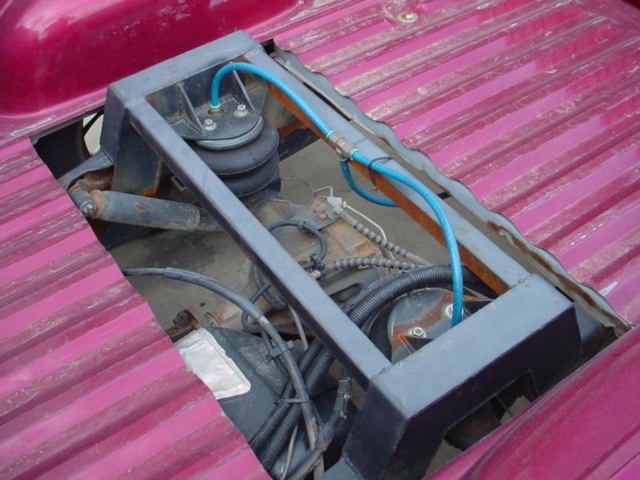

how low can i go whit out chopping out the frame, like this
borrowd a pic from a project her, hope that is ok

You can do 3 or possibly 4" lowering blocks without cutting the frame.....maybe eve 5"...but I think your cutting it pretty close there.....I am gonna do 5 inch and shackles...but I am throwing a notch in....
I would do some measuring and get a exact height you are desiring and then figure out if you can do without chopping the frame up.

this guy ride on 18 but he has air shocks, (where do i buy that, how do i set it up, some one have a link to a project that has set up air shocks) do i need to chop the frame for that ?.

As far as RacerX's air shocks...I am looking into what model shocks he used as he cant remember the model #'s....I just contacted him myself.....you wont have to chop the frame but its not just straight nut and bolt...mostly but I believe there will be a lil figuring on getting them in there...will keep you updated on this as I learn and find more. Oh and air shocks...local auto parts stores...$65 a pair from autozone...mount, run air lines, drill a hole for the T fitting...screw together...air up/down till happy While I would LOVE to find some that are faster....and I know me....I WILL find a way...I will be looking into a way to work on these as well
