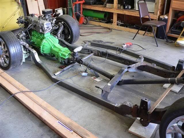

I didn't Z mine, but isnt the body mount right where you are talking about Z'ing it under the cab. I think if you do it right at the suspension and make some nice gussets it would be the least noticable. The Z would be hidden from view while looking into the wheel well opening because it would be right behind the wheel itself. I still think it looks fine when you do it just infront of the firewall also.

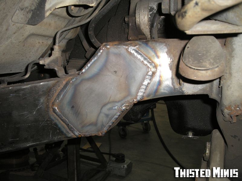

you should check out YotaScene.com man there are a ton of threads on this subject there. It's amazing how similar the frames look.
twisted minis's avatar
twisted minis
bodied b2600zx (josh)
Ya, i remember that pic from your build, Seth. . . Mine won't be that big but still the same look i guess. . .

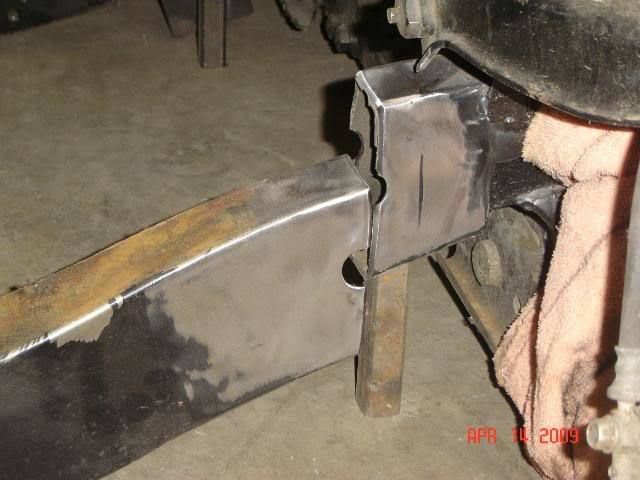

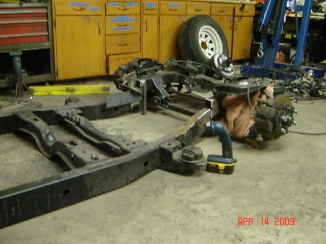

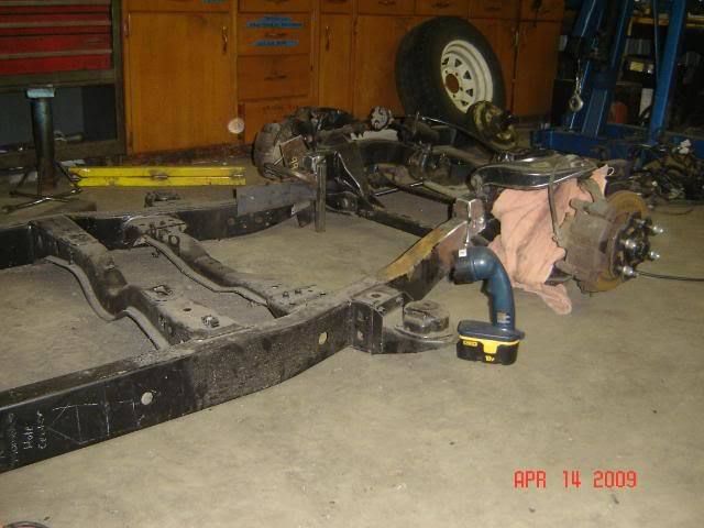

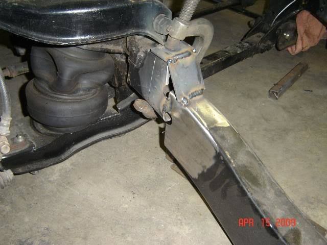

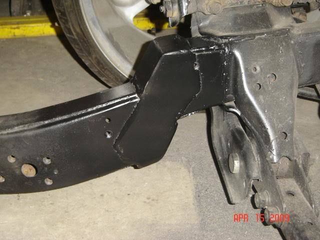

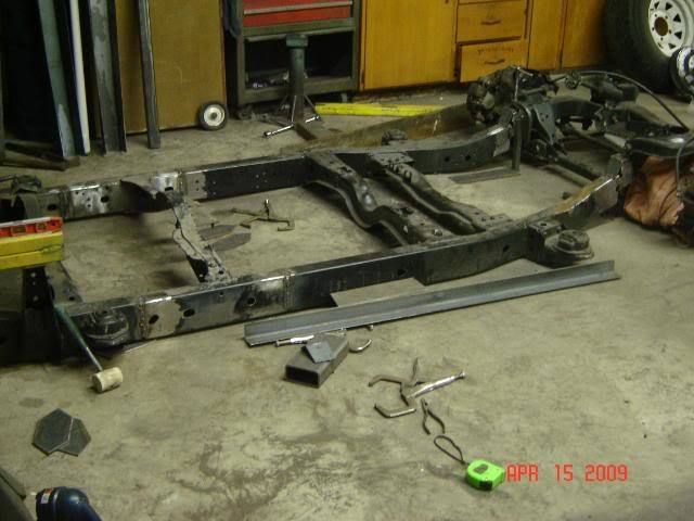

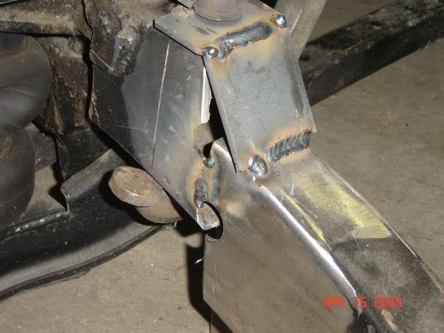

tuckin20s
Hard t see but I took 1X1 and tacked it at the 4 corners of the front clip while the frame was layed out. One at each core support mount and one on each frame rail by the Z. That way I knwe the front was as low as I could go or want to go.
Frame all boxed in.
Hope some of this helps!
Thanks for the pics bro
