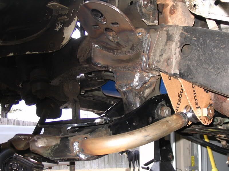

Heres a picture from 2006 of my frame you can see the AIM brackets on the front.
And here is from early 2008 when I replaced them, they were still being mocked up it this pic, and I know people even get the bags closer to the frame than I did.

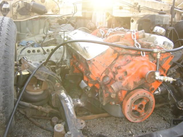

Yeah you need to redo you bag mount. You can move the bag in towards the frame more like in the this pic. I will be doing this also cause I'm going need the lift. This is from BodiedB2600zx (Josh) he has a build thread on here with more pics.
