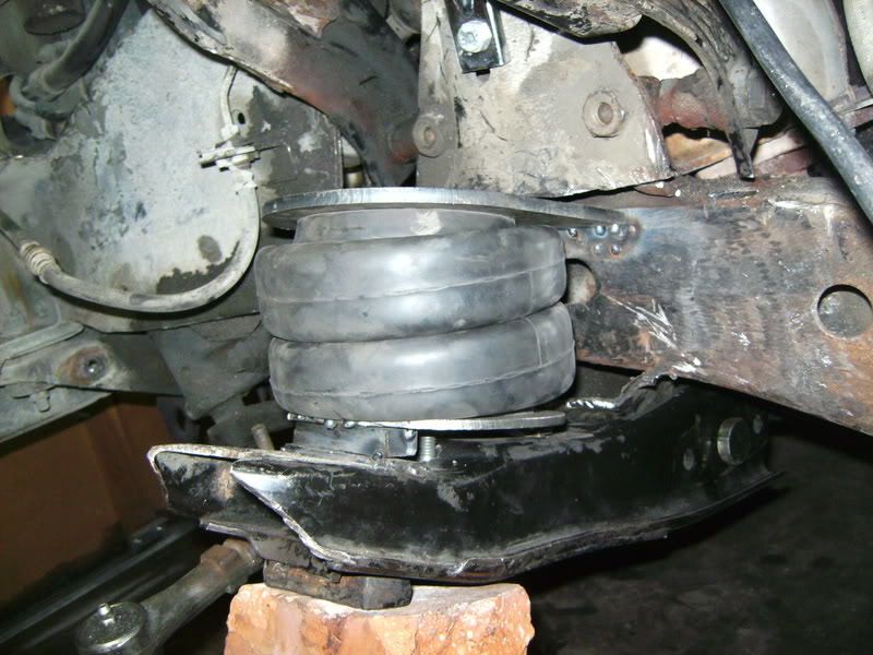

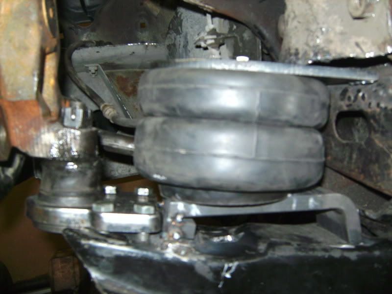

Alright this is my first time ever bagging a truck, and i have ran into a problem that hopefully you guys can give me some insight on. I can only get my bag to fully pancake if i put my lower bracket like this, and i dont get shit for lift.
Now if i put my bracket like everyone else i have seen my bag does this crap.
hopefully you guys can steer me in the right direction on what to do. ive been fightin with this all weekend and im gettin really frustrated thanks

would the second pic work since i would be fully layed out anyway?

neither of those look right or safe to me, what you should do is, look at other peoples install, and really inspect it,
you can also angle the upper bracket up to correct the bag not sitting right
check this link out, it should help you
looks like your angles are wrong move the bottom spacer to the other side and adjust the top to match

yeah i see what ur sayin..do you think i cut my top bracket to short? Do i want the top bracket even with the frame or do i need to angle it up?
