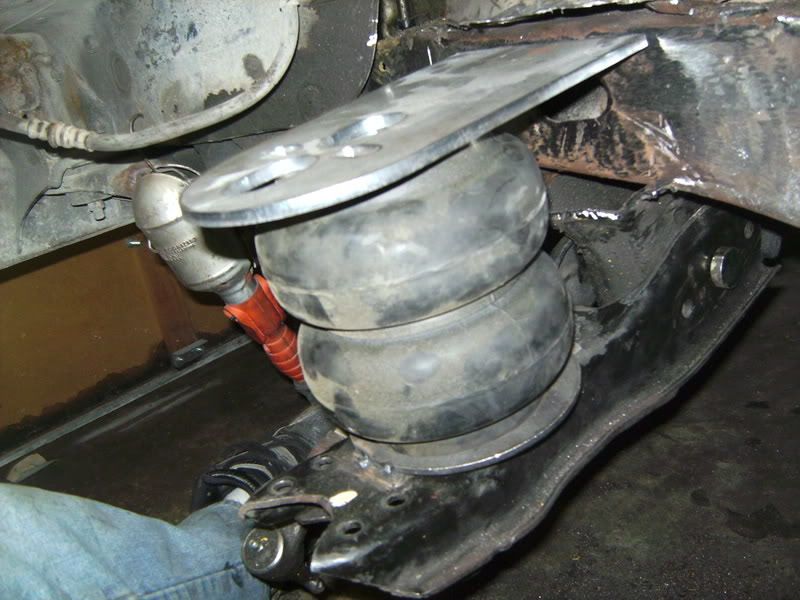

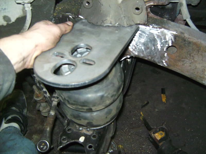

my bag mount looks way too long..do i need to cut part of it off? I know you want the bag as close to the frame as possible but if i leave it the way it is the bag is at least 4in away from the frame. I will post a pic once the batt. in my camera is charged.

this clears things up

yes you have to cut the mount to fit.keep in mind you want the bag to completely collapse on itself. they come that way because the are a universal torsion bar bag mount.

thats what i was thinkin..about how much should i cut off?

Ya you have to see where the mount SHOULD be and measure to see how much you need to cut off. . . I cut off, i think, if i remember correctly, like 4" off mine. . But you shouldnt cut off as much as i did. . I don't think. . .

What I would do, is pancake the bag. . put a plug in it, to keep it pancaked. . raise the lower control arm to where it will be when laid out. . place the bag on the arm. . And measure from the the frame to the center of the bolt holes on the bag. . . And then transfer that to the bag mount. . and cut off a lil less than you measured jus to be safe. . then test fit it. . and cut off more if necessary to get the bag to pancake perfect. . . jus make sure to get the upper and lower mounts parallel with each other so the bag sits right when dropped. . . And doesnt pancake crooked. . .

so you want the mount off center like in the pic above^^^

And sittinlow22. . to answer your question, the bracket is "offset" because its centered up on the lower control arm. . . Its not really offset. . .

Those aim brackets will cause your bag to rub on the frame. But yeah it will not be centered under the upper control arm mount because its centered on teh lower control arm
