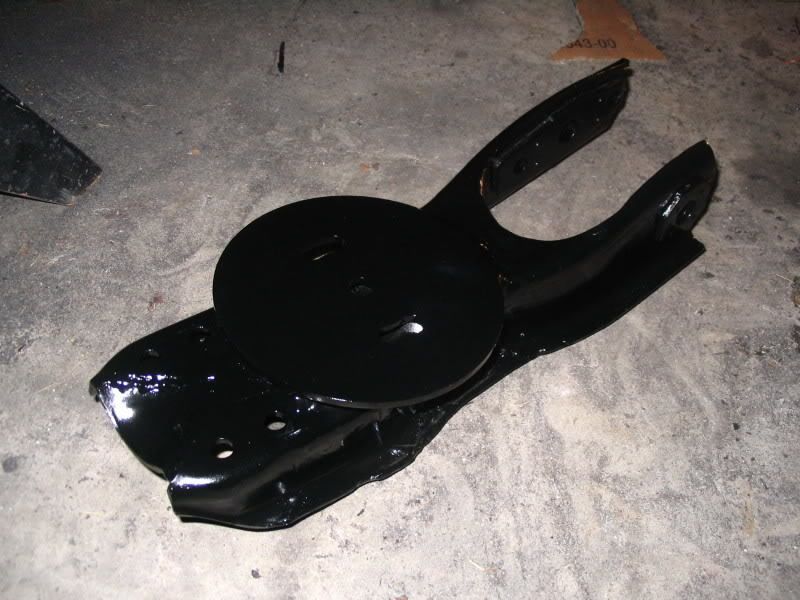

The only things you do with the lowers is cut it out a lil bit so it doesnt hit the frame when you lay the truck out... and weld the lower mount on...

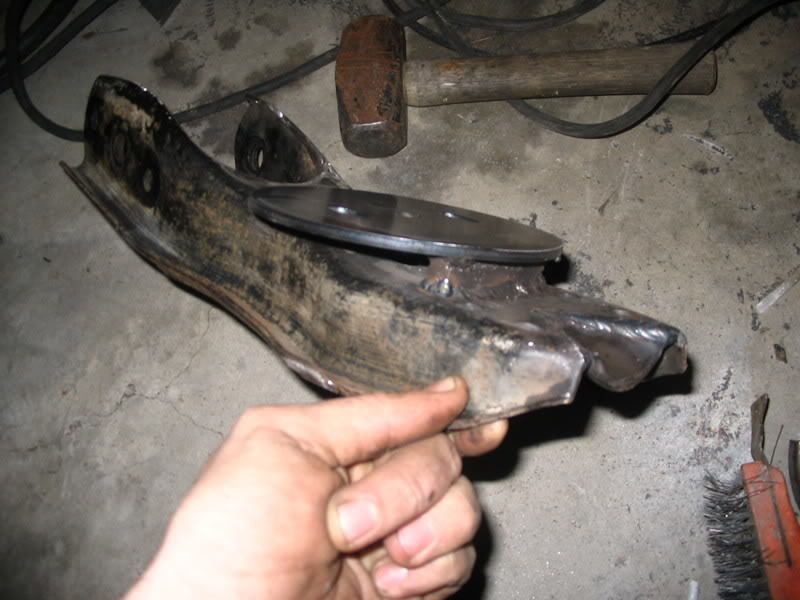

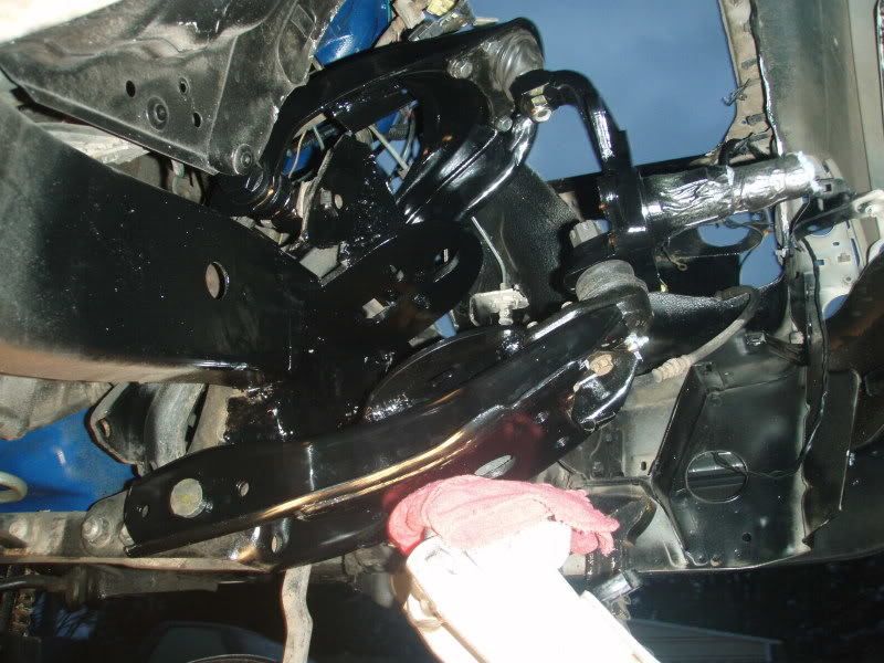

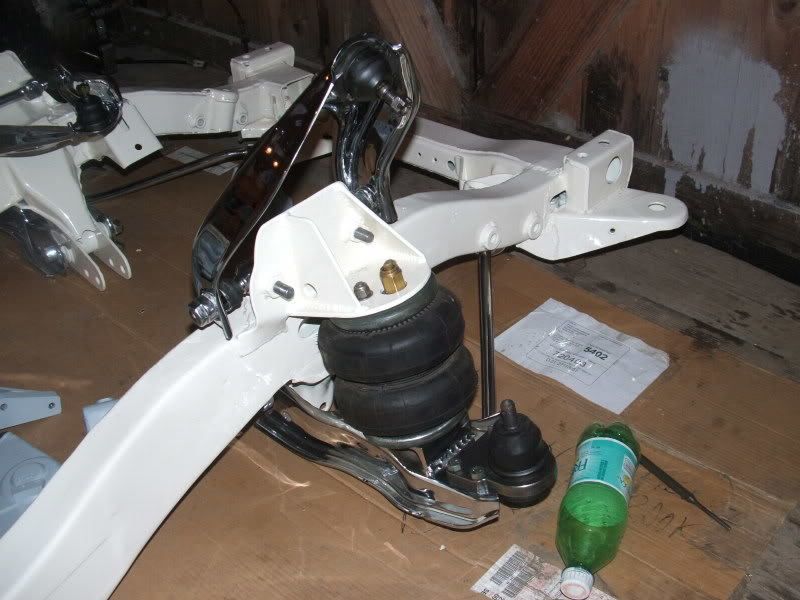

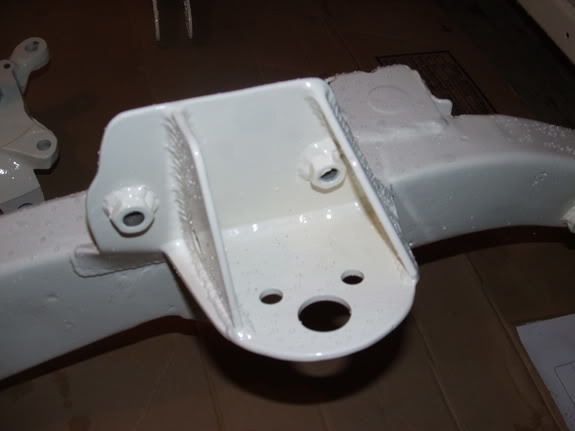

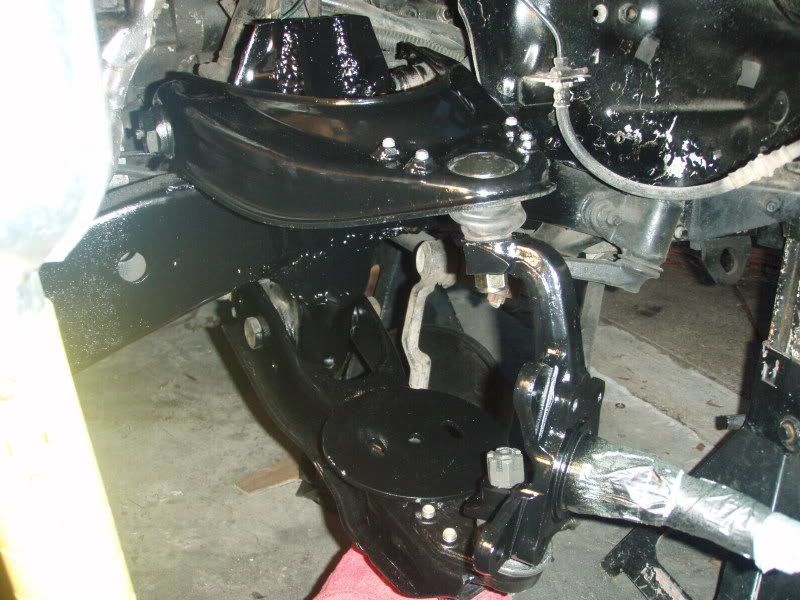

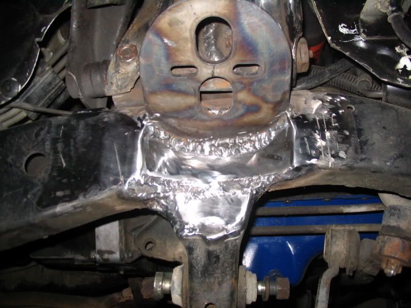

And c channel?? I don't know what you mean.. Is this the first time you've bagged a truck?? Mazda's probably aren't a good first try, haha.. Here's a few pics of mine... I cut into the frame to set the bag in closer to the pivot point on the frame... You can see the bag mount welded to the lower and the upper mount...

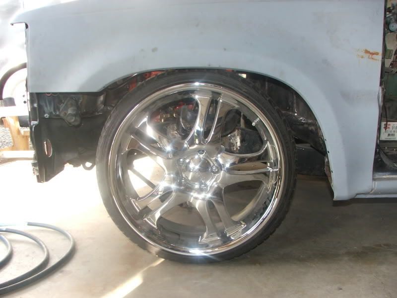

And ya man, i think you should def do like how i did mine and notch INTO the frame so you can move the bag farther in... I'm baggin mine to lay on 20s with a 30 series tire... 25.3&quot; tall tire AND 2.75&quot; bodydrop so I'm needin MAX lift also. My front setup will def do that... At 100 psi i untuck my tire by 3 inches and im not bodydropped yet. So once I am, i'll jus untuck the tire at 100 psi. Which is acceptable to me

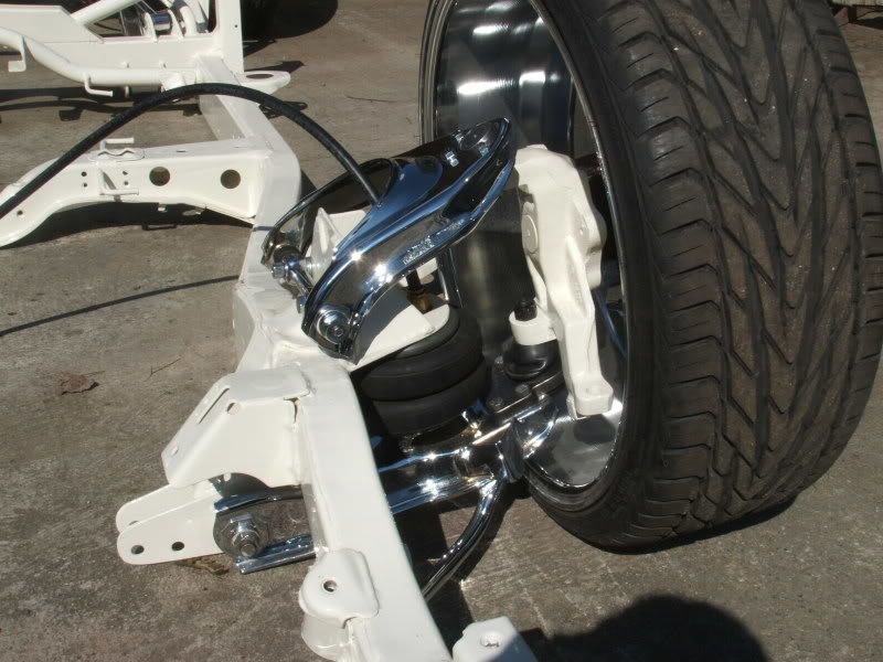

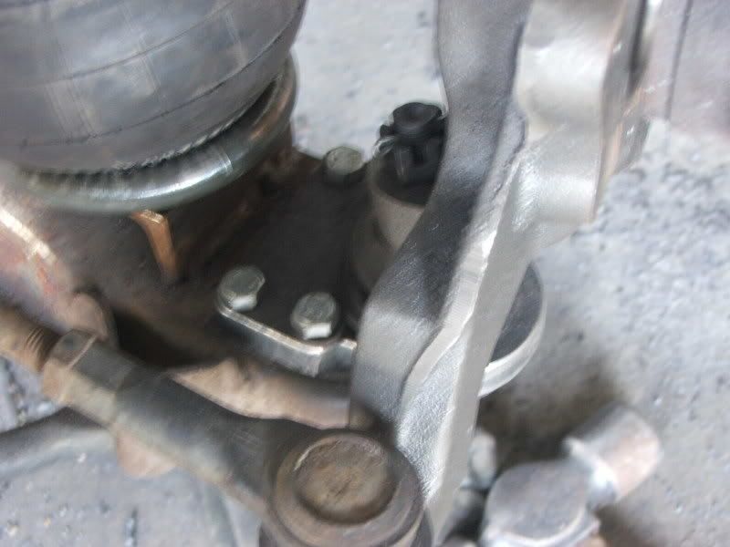

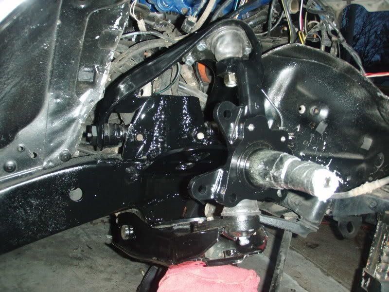

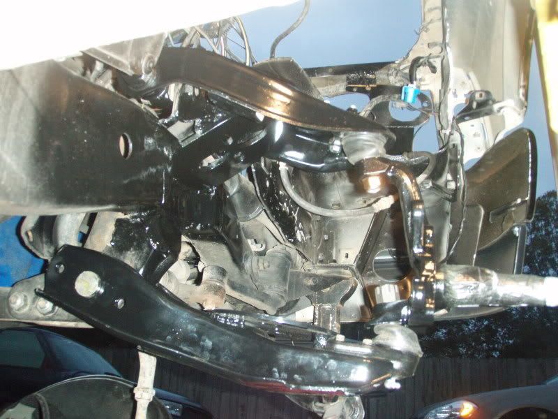

Ok... well i went out and played with the ball joints a lil and took some measurements... It was quite surprising actually. The lower ball joint is locking out and restricting the amount of lift i will be able to get. And the upper ball joint is restricting the drop.. obviously I guess. I measured the tip of the spindle at full lift and full drop and there was only 9 inches of travel... That really sucks. If I unbolted the upper ball joint, I got another 2.5&quot; of travel up from the lower control arm. So I think I should reverse pie cut my uppers and I was thinkin bout puttin a couple washers under the outer 2 lower ball joint bolts to angle it up a lil and maybe get a lil more lift Here's a few pics to show you full lift and drop....
