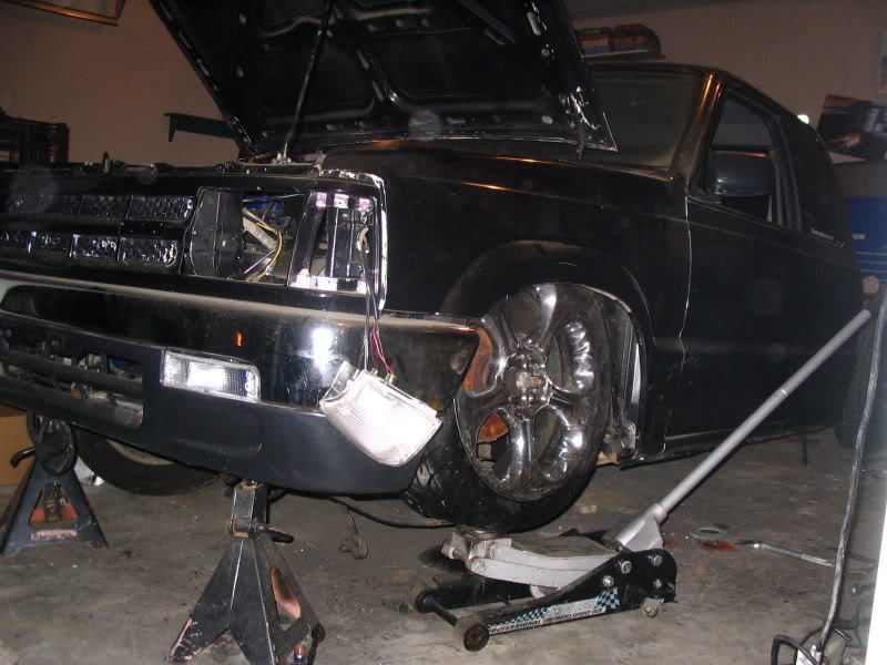

bodied b2600zx (josh)
Ok.. well i got the ball joint literally flipped over and still on the under side of the arm. I may put it on the top side still, I'm not sure yet. got the toyota ball joint in place and bolted on. I got everything cut out, for the most part. The lower control arm is still hittin the frame. I'm guessin I need to cut more out still. But I got the spindle put on and the wheel well cut out so its not hittin anymore... So at the end of the day, I'm tuckin a lil rim <img src="{SMILIES_PATH}/icon_biggrin.gif" alt=":D" title="Very Happy" /> here's a teaser....
