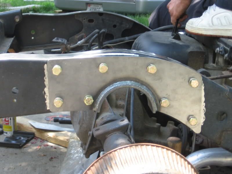

jmzcustomz (jeff)'s avatar
jmzcustomz (jeff)
Here is a pic of a bolt in c notch. How this helps.

That pic above has no welding. You basically mark your frame (I believe that most kits come with a template) where the little notch would need to be cut out as well as where to drill the holes for the bolt in kit.
add some air shocks to keep you off the frame
