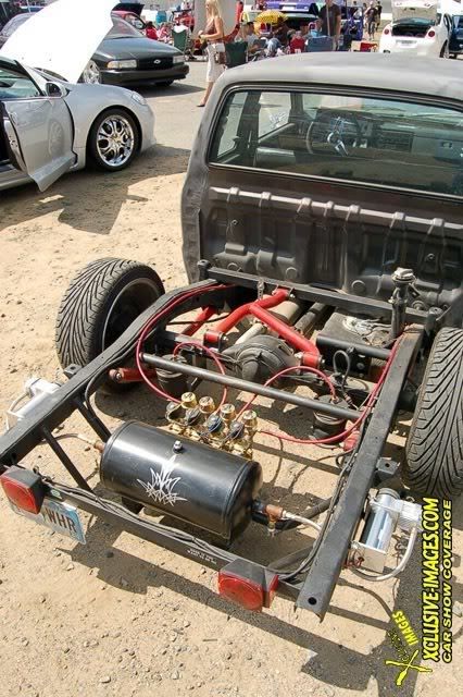

mazdawg(mikey)'s avatar
mazdawg(mikey)
i got my valves mounted on the tank and my tank is mounted under my bed. like rick said, its easier to work on them all together instead of some under the bed, some under the truck. plus easier to wire all them at one single location. heres a pic of mine.....
